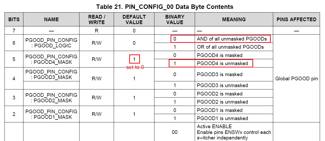

My application will use 3 of the 4 outputs of the TPS65400.
Will the PGOOD be driven when only the three enabled outputs power up correctly?  I am tying the EN4 input low because I am not using the 4th output.
I may have missed it, but I don't see anything in the data sheet that explicitly defines the PGOOD output function.  It looks like the AND function of the four outputs, but I'm hoping that if an output is not ENABLED, it would not have an effect on PGOOD.
