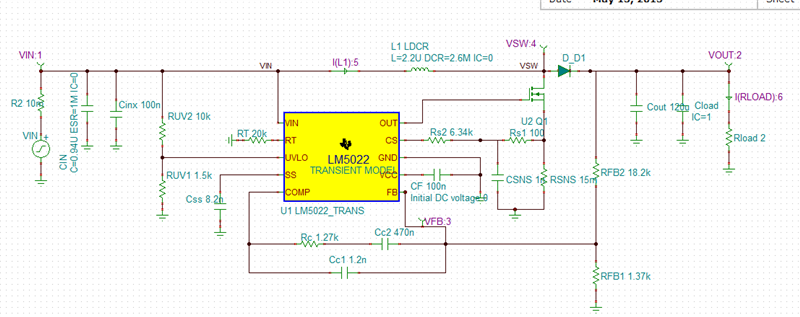

Hi team,
I have done a design using webench and do some modification, could you please help double check this?
Vin=12V(10~14V), Vout=18V, Iout(max)=9A,

Hi Youhao,
Attachment is the datasheet of MOS and Diode customer selects.
For Diode, the peak power consumption would be more than 10W.
Do you have any suggestion for this two components selection? Thanks.
