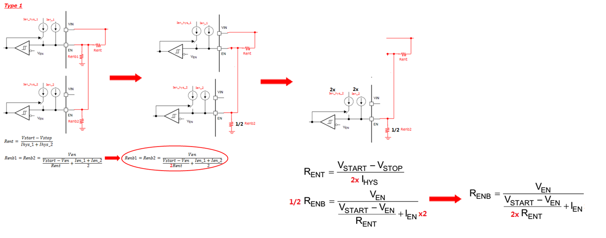

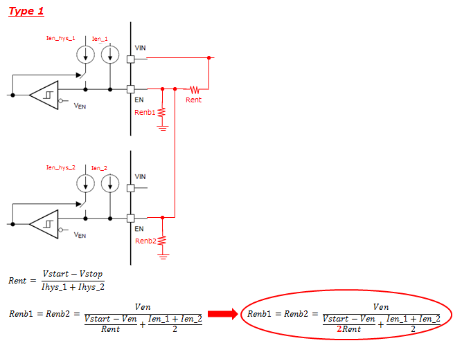

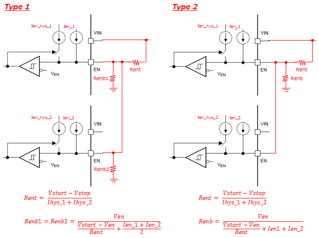

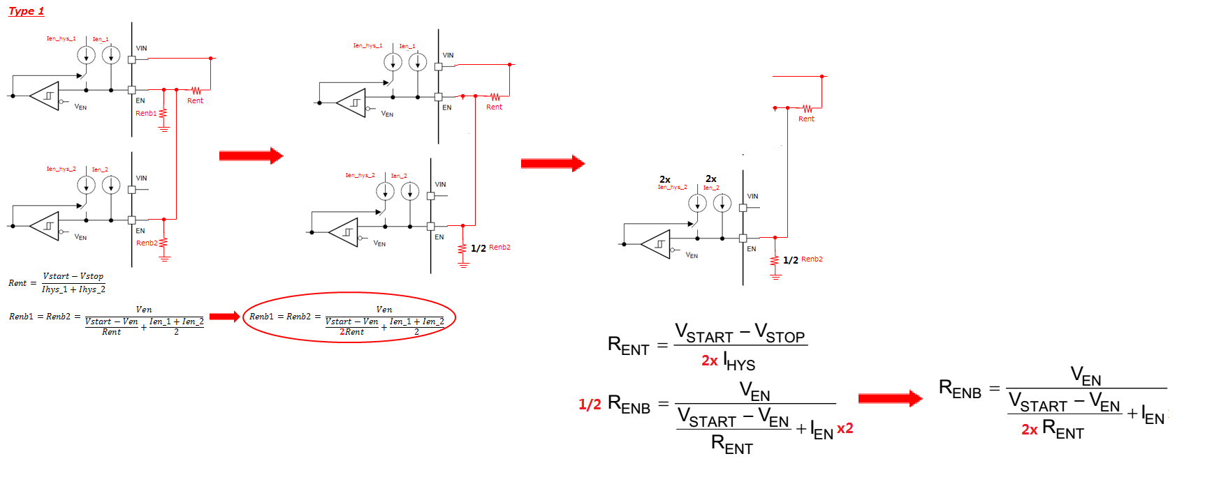

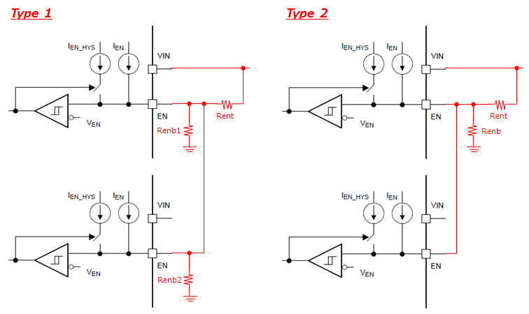

We got a question from the customer about LMR14030-Q1.
Could you help us?
[Question]
They are considering using two LMR14030-Q1. But they need compact layout. Therefore they are considering 2 type of EN resistors circuit. They want to use either one. Please refer to below circuit. Are there any concerens about these circuit?
