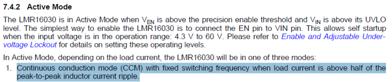

LMR16030: What is the peak-to-peak inductor current ripple?
Part Number: LMR16030
