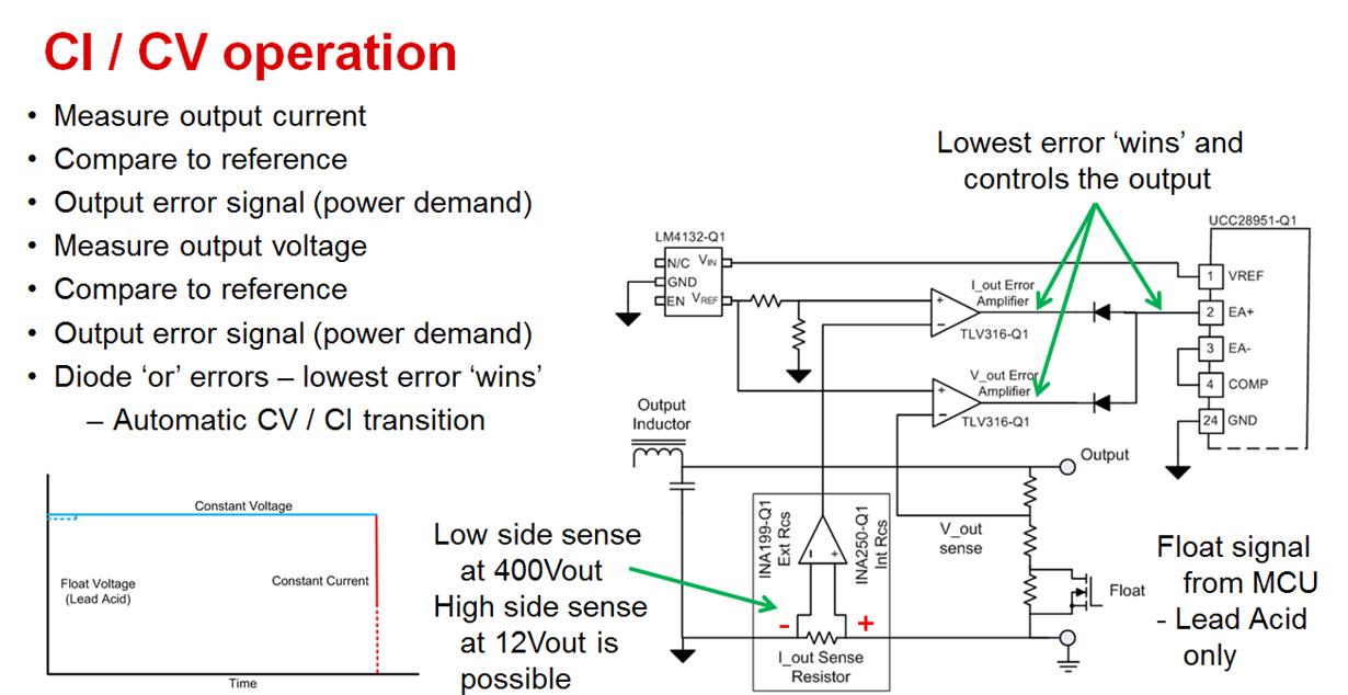

    2/ The feedback network is a classic feedback implementation to achieve a constant voltage / constant current output characteristic. If you don't need CI operation then simply remove D3 in your schematic and all of the components feeding it. Assuming that you are monitoring the PSFB input current, you will still have current limiting at the output - but the current being limited is the INPUT current and the proportionality between Iin and Iout will depend on both Vin and Vout - so it is current limiting but with larger variations in the actual output current limit point than you get with the CV/CI circuit. The CV/CI circuit of course also needs input current monitoring to effect peak current mode - you can see this in the diagram on slide 7-21 of the document slup349
    If you use the UCC29002 load share controller you will have to add a Vout sensing function to the PSFB output and the resulting system will be 'democratic' in the sense that no one power module is a master.

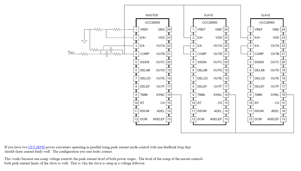

    If you are willing to use a master / slave arrangement then you won't need a separate load share controller and can configure the three UCC28950 devices in parallel as shown below. the master has control of the loop and the current demand signal at the output of its error amplifier is fed to the slave units. of course if the master fails, then the whole system stops operating.
