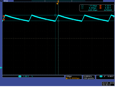

  • Is it possible to see scope waveform for this device, with OVP triggering. Ideal case should be for 100mA, with 5V input and output set to 6.5V. To see how after enabling voltage rising close to 6.5V and OVP triggering in action. If this is not possible, than waveform for OVP triggering for similar device. If this already exist in any similar device datasheet, please point me.
  • here is the OVP waveform of TPS61220 but different input and load condition. the OVP value varies from different VIN, load and device. so i would not suggest setting VOUT higher than 6V,
  • I am not sure if I am looking this graph on the right way. Can you just clarify points, with max 7.2V and minimum 6.5V value (related values to this waveform, not in general). Is this graph related to device that is (normally) switching (voltage rise) up to 7.2V, and than OVP turns off switching until voltage drop down to 6.5V. And it is repeated again. Or on graph is something else?
  • your understanding is correct.
