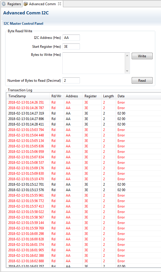

  • As a corollary,  when wake is attempted via comms; the bq28z610 oftens refuses to acknowledge it's I2C address.  Using bqStudio and the Adv Comms Tab, a word read is rejected multiple times over a variable time period of up to 10-15s as shown in the attached.  Since the address is not accepted or acknowledged, the part does not wake and the CHG FET stays off.  Is this the intended behavior?

    That last screenshot is not an expected way of operation. If you have gone into sleep via command with in system sleep, it will wake up on active comms.

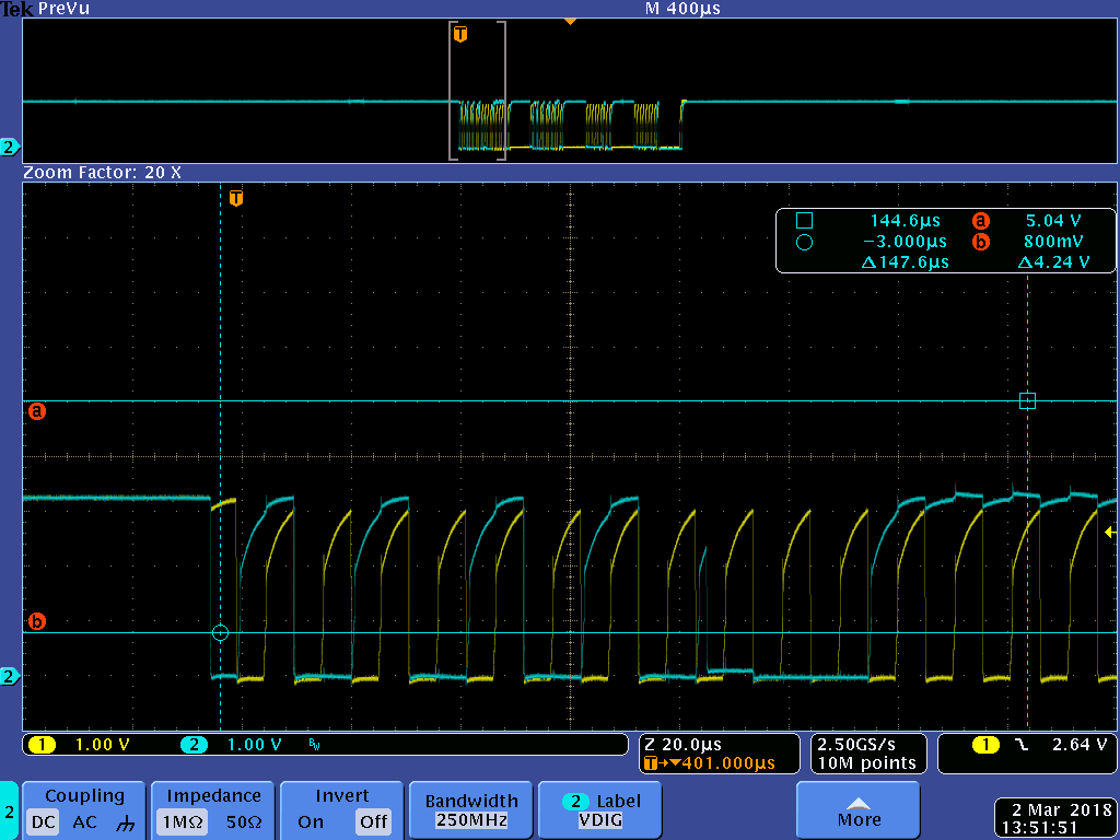

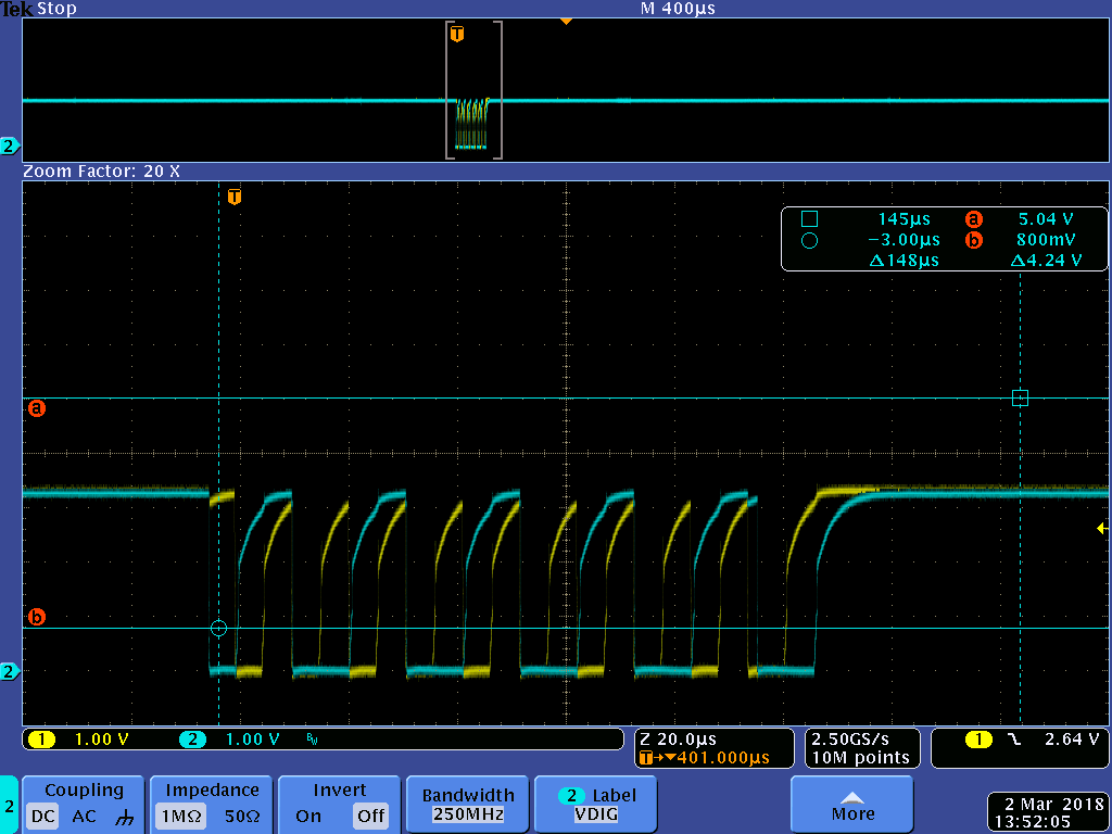

  • Here is what I see on our platform, which is fundamentally not different than the reference design for the part in the datasheet.
    Valid read transaction with bqStudio and EV-2400 (part was already awake):

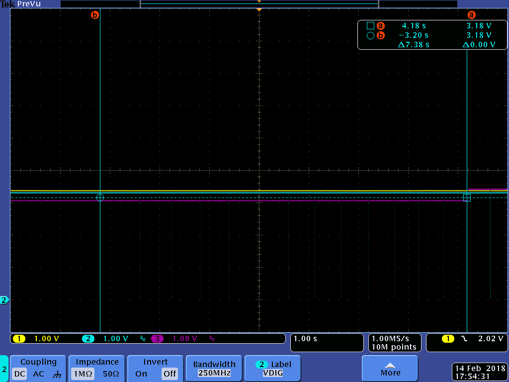

    Unacknowledged read attempt after 30s and part sleeps (CHGFET off):
  •  The waveform from EV2400 looks OK. Please, re-send I2C command within 400ms since the gauge would not be waken-up at first I2C command.

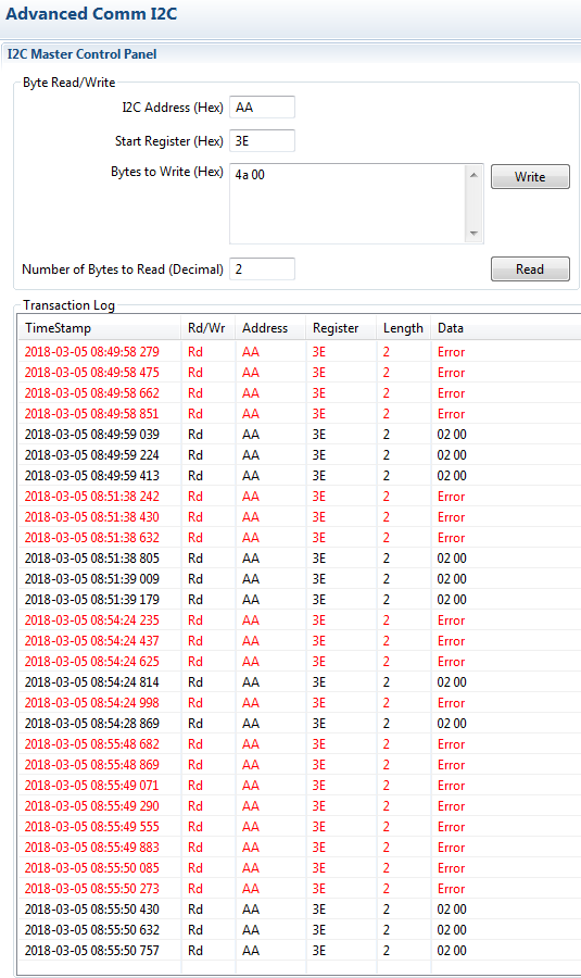

  • I can manually resend the read request (via bqStudio) within <200ms and it does not respond.
    If I do it repeatedly, it will eventually respond.  It looks like it can take between 760ms - 560ms or <200ms comms attempts (4-5 tries) until a response occurs. Although sometimes an error occurs immediately after a good response.  But at this point it is out of sleep; so that isn't a concern.
    The scope shots aren't really helpful to illustrate, but the adv command log shows:
