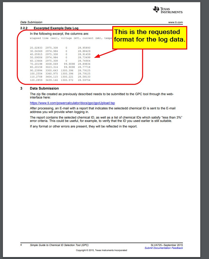

I'm trying to find the best match of a Chemistry ID for a Lithium Ion battery cell. The exact cell part number and manufacturer are not listed in BqStudio so I collected the data as outlined in the "Simple Guide to Chemical ID Selection Tool (GPC)". The instructions indicate collecting a rest, discharge, rest log for the cell, then zip together a config.txt and name the log file "roomtemp_rel_dis_rel.csv". I did all of that and submitted the file to the GPCCHEM web page successfully. But the ZIP file is not accepted, with the error messages:
There was a problem with the content of the zip file.
  • Invalid Zip File Member - roomtemp_rel_dis_rel.csv
  • Required file 'hightemp_highrate.csv' is missing from the input zip file.
  • Required file 'roomtemp_lowrate.csv' is missing from the input zip file.
  • Required file 'lowtemp_highrate.csv' is missing from the input zip file.
  • Required file 'lowtemp_lowrate.csv' is missing from the input zip file.
  • Required file 'hightemp_lowrate.csv' is missing from the input zip file.
  • Required file 'roomtemp_highrate.csv' is missing from the input zip file.
Are the instruction on the web page incorrect?

    I formatted the data exactly as requested in the document describing the instructions for submission, "Simple Guide to Chemical ID Selection Tool (GPC) SLVA725–September 2015". Contrary to your suggestion, the document includes 10 lines of sample data that include 3 decimal digits (see the attached screen shot below). If the instructions in the document are incorrect then perhaps somebody at TI could update the document to include the correct sample data format?
