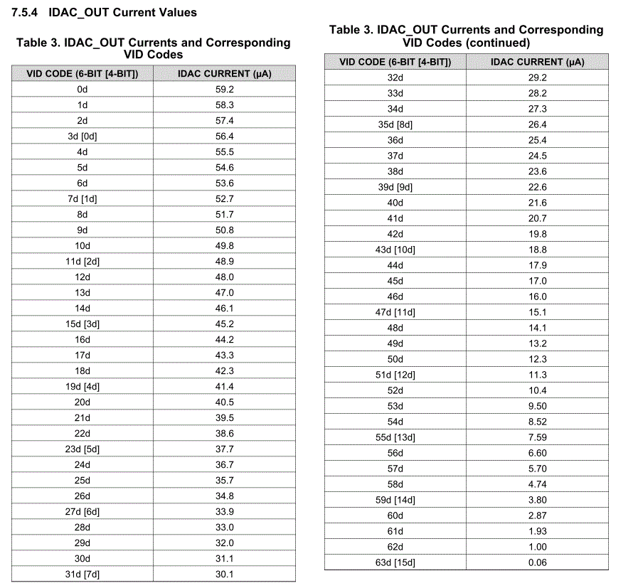

When using in 6bit-mode, can IDAC_OUT at startup only be set to [0d] ~ [15d] in the following table?
If possible, I would like to set it to 53d, but how do I decide the resistance value of Rset in that case?

Yuto-san,
The default start up values are given in the datasheet and I would recommend either 200k/11.3uA or 215k/7.59uA for Rset to get closest to your desired value.
