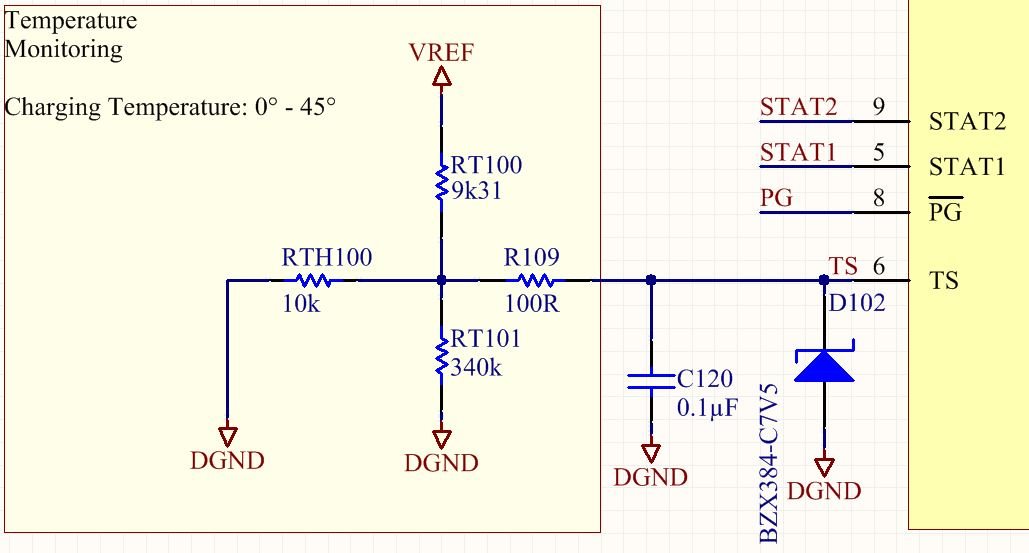

When i switch on the power source the PG LED is lighting up. after about one second, it starts to flash with a freuqency of about 10 Hz.
Does this indicate that VCC is invalid? I didn't find anything about flashing in the datasheet.
VCC is at 24V

  • I found out what is causing the problem. It is the thermistor. When I disconnect it everything works fine.
    So I put a power source instead of the thermistor and varied the voltage. At about 1.3V the PG LED starts to flash and the state 1 LED starts to light. If I reduce the voltage it stops at about 1.1 V.
    Here is the part of the Circuit:
  • More details about this Problem:
    Voltage without thermistor: 3.2V
    Between 2.4V and 1.1V PG starts to flash and State 1 starts to light. above or underneath this voltage area only PG is lightning.
  • PG behavior should not relate to TS pin. TS 3.2V is >VLTF which charge is suspended. STAT1 and STAT2 should both be off. Between 2.4 and 1.1V charge is allowed, if device is charging, then STAT1 should be on. So the charge status pins behave correctly. However, PG pin should not relate to this. Does this behavior happen on multiple boards? Have you tried with a different IC on the board?

  • ACDRV turning on and off is the reason for PG pin to flash. Can you probe VCC in comparison with SRN.

  • Do you have the battery connected? Why does SRN oscillate from 5V to 23V?
    From the scope capture, you can clearly see that the VCC-SRN voltage is < 100mV. TI recommends an input voltage of at least 1.5 V to 2 V higher than the battery voltage, taking into consideration the DC losses in the high-side FET (Rdson), inductor (DCR), and input sense resistor (between ACP and ACN), the body diode drop of RBFET between VCC and input power supply, and battery sense resistor (between SRP and SRN).
    Can you please try to increase the input voltage and test again.
  • I solved the Problem
    I incerased the supply Voltage and it worked. It did't work because I configured it to charge the Battery with 25V but was supplying it with 24V.
    I always tought that it would just charge the battery with less voltage. That was my fallacy
