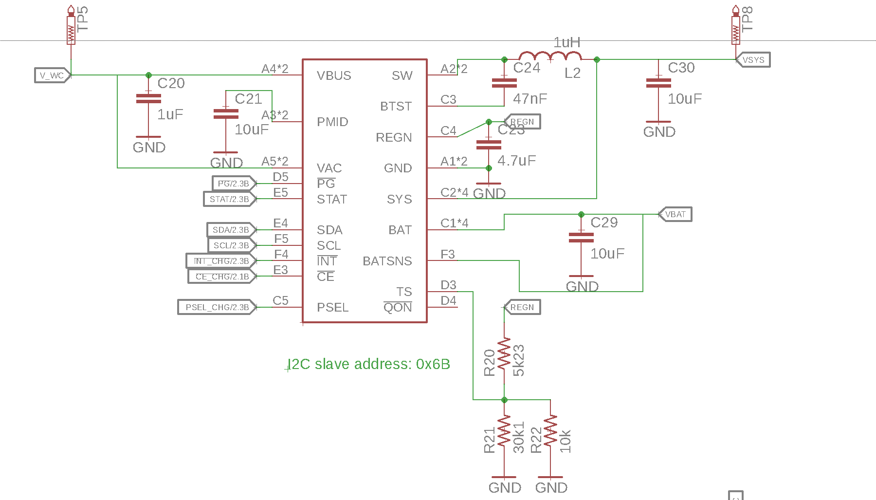

We have designed a PCB which uses a bq25600 as the charger for the Lithium Ion system battery. In approximately 30% of the devices, we encounter an issue where the bq25600 starts consuming 100mA whenever the battery voltage rises above 4.05V. The charger then does not resume normal operation (and keeps consuming power) until the battery voltage falls under 3V.

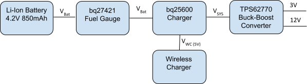

The system architecture for the power section of our device is the following:
The issue persists even if we replace the battery with a battery simulator and the wireless charger with a conventional power supply. Using a thermal camera, we notice that the bq25600 becomes hotter with respect to its normal behavior.
The bq25600 is configured by a microcontroller as follows:
Minimum system voltage: 3.0 V
Input Current Limit: 500 mA
Charge Current: 240 mA
Precharge Current:120 mA
Termination Current: 120 mA
Regulation/Charge Voltage: 4.242 V
The CE pin is connected to GND and the PSEL pin is connected to Logic High (3V).

The schematic for the charger is the following:
We would really appreciate any help in solving this issue. Let me know if I can provide any additional information.

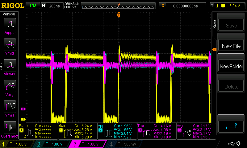

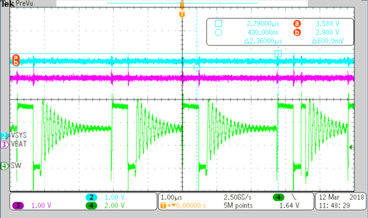

    I am curious if you can take a waveform of several channels of the charger. If the fault occurs immediately after the applying the input source to VBUS, please capture these nodes during VBUS plug in. If not, does the charger charge the battery for some time before the fault occurs?
    Channel 1) VBUS - Input voltage
    Channel 2) SW - Switching node
    Channel 3) IBAT - Battery current
    Channel 4) IBUS - Input current
    Joel H

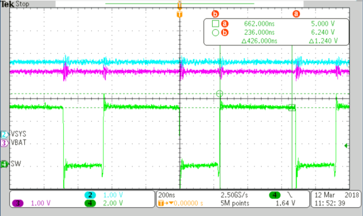

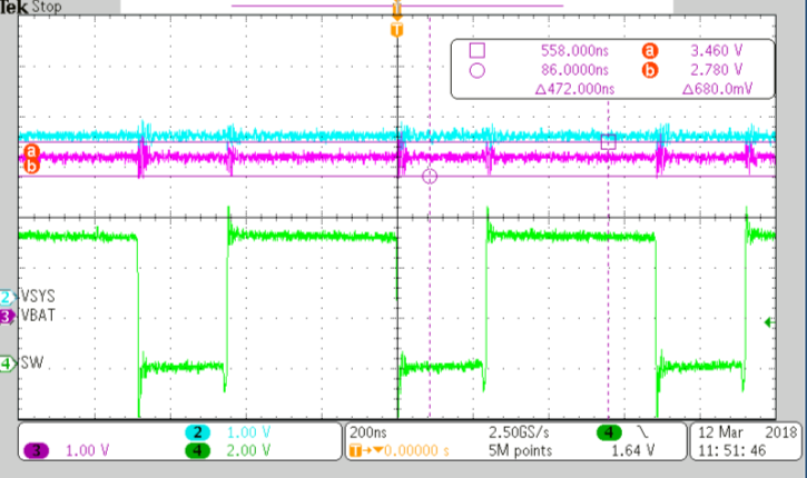

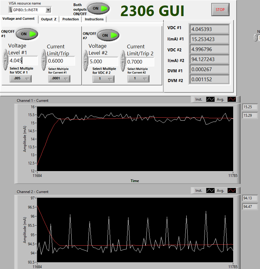

    We are using a Keithley 2306 Battery Simulator to replicate various conditions in the system. In our setup, Channel 1 is the battery and Channel 2 is VBus. We are monitoring Vbat and SW with an oscilloscope. Channel 1 of the oscilloscope (Yellow) is Vbat and Channel 2 (Blue) is SW.

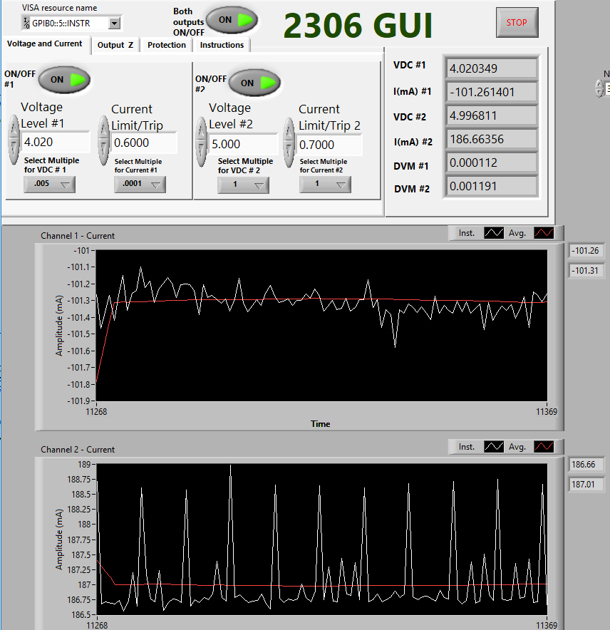

    If we connect the charger (enabling channel 2 on the Keithley) when Vbat (channel 1) is 3.2 V, we get:
    We can increase Vbat and the charger continues to operate normally:

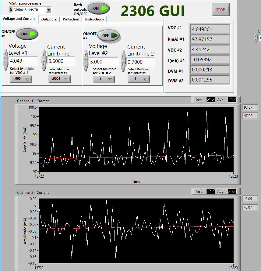

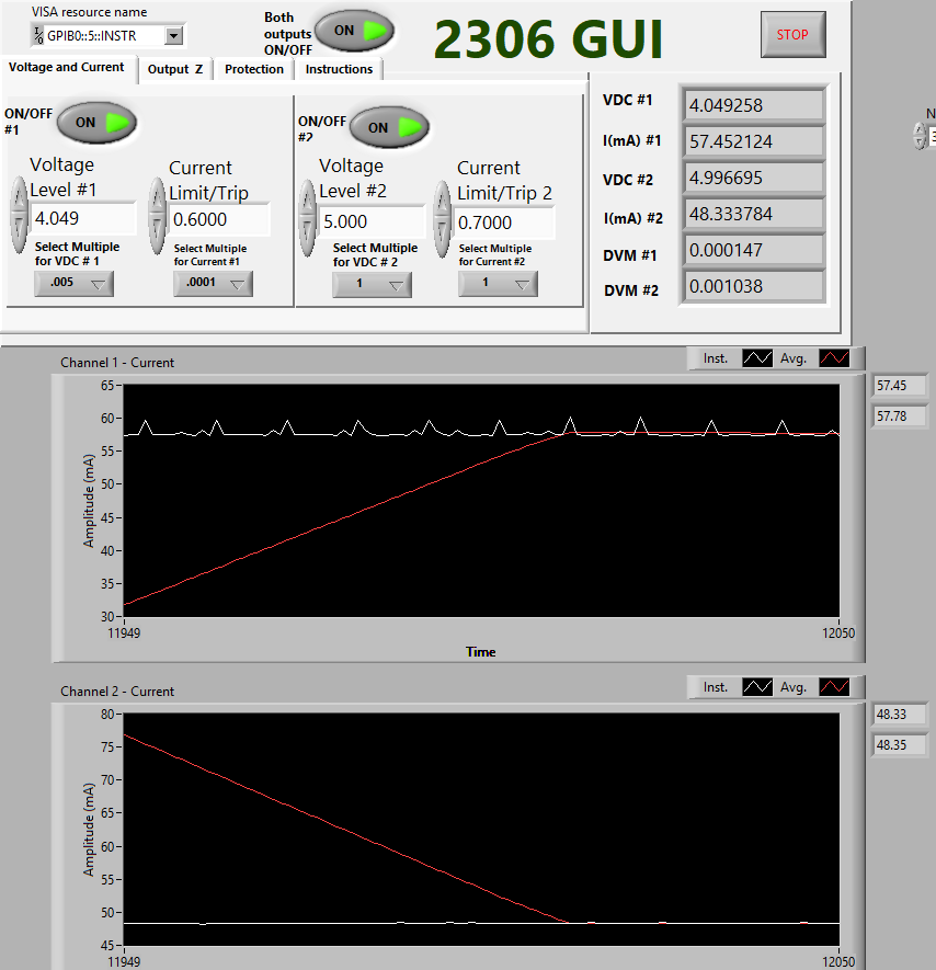

    But when we get closer to 4.05V the charger starts draining current from both Vbat and Vbus:
    At Vbat = 4.05 V the charger enters the fault condition:
    And keeps consuming ~100mA even when the charger is disconnected:
    We have also recorded the behavior:
    Let us know if we can capture any additional signals that can be useful in troubleshooting the issue.
    Thanks again for the help!

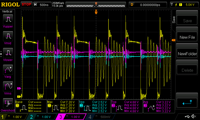

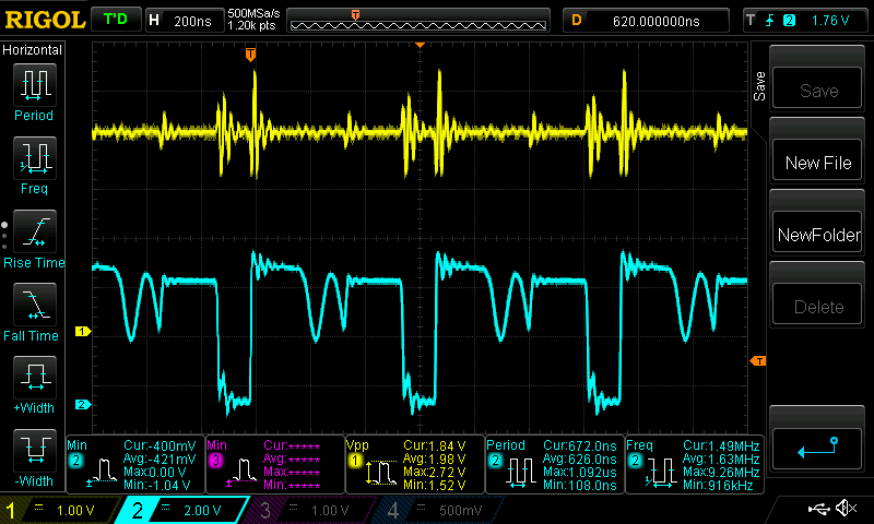

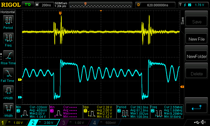

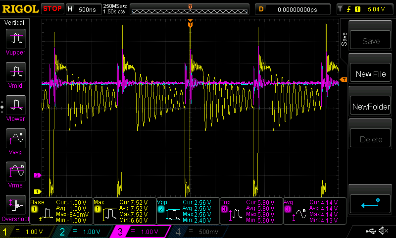

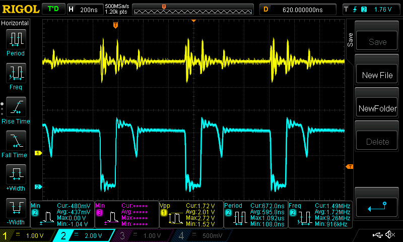

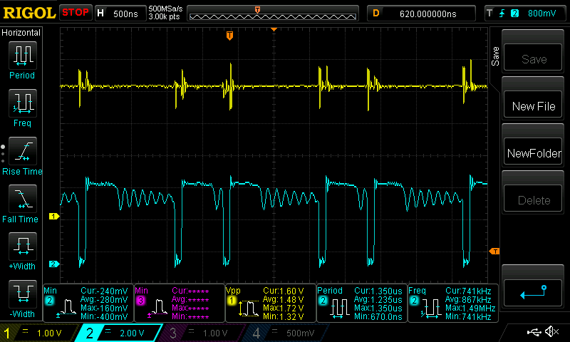

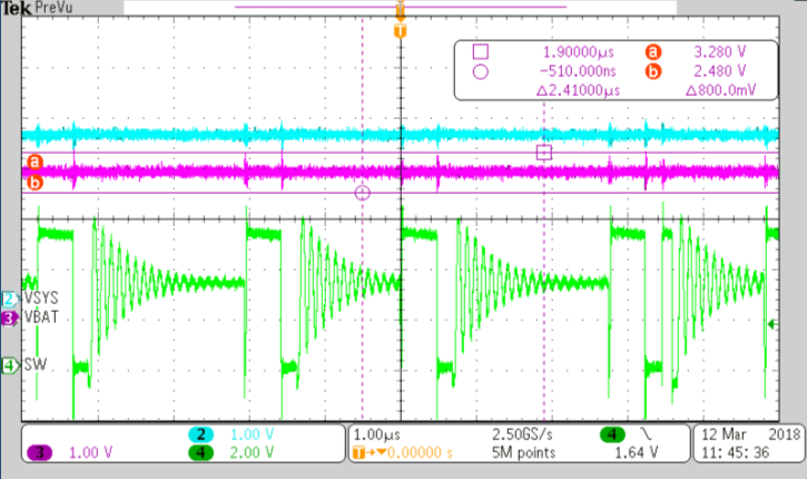

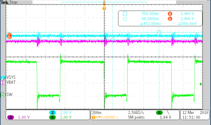

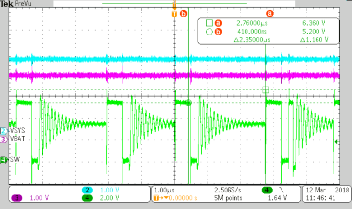

    Nonetheless, we still encounter the same issues that we were experiencing before. We also checked the values of the passives connected to the IC and everything seems to be matching the suggestions on the datasheet.
    We have also tried adding capacitance on Vsys but it does not look like it makes a difference. Is it possible that this could be an issue with the switching controller?

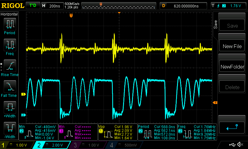

    We have also attached to additional screenshots.
    For this setup we have:
    CH1 (Yellow): Vsw
    CH2 (Blue):    Vbat
    CH3 (Purple): Vsys
    Registers are set as follows:
    [BQ25600] Register 0: 0x0A
    [BQ25600] Register 1: 0x14
    [BQ25600] Register 2: 0x90
    [BQ25600] Register 3: 0x11
    [BQ25600] Register 4: 0xC1
    [BQ25600] Register 5: 0x8F
    [BQ25600] Register 6: 0x66
    [BQ25600] Register 7: 0x4C
    [BQ25600] Register 8: 0x74
    [BQ25600] Register 9: 0x00
    [BQ25600] Register 10: 0x80
    Charging current is set to 980mA, precharge is 120 and termination is 120. IINDPM is set to 1000mA, charge voltage is set to 4600mV and we have also changed the recharge threshold to 200mV.
    In the first capture (below), the charger is working in precharge (Vbat=2.809V) and charging the battery at 120mA. However, the "ringing" waveform (which usually appears during faults) is present.
    Increasing Vbat to 3V, the charger starts the CC charge and recharges the battery at the :
    The charger operates in this way until Vbat reaches approximately 4.10V and then fails as usual. The content of the registers is the following:

    The problem always seems to arise whenever those oscillations appear on Vsw, with period 120ns. Any suggestions or tests that could help to diagnose the issue?
    Thanks for all the help,
    Luigi
  • Hey Luigi,
    Based on the waveforms you provided, it seems that there is heavy ringing present on SYS, BAT, and SW, more than we have seen in our testing.
    Please note the comments on the waveforms I tested on our bench with one of our EVMs
    Channel 2, 3, 4: VSYS (Blue), VBAT (Purple), SW (Green)
    Below is similar settings to you, VBAT ~ 2.8V in precharge with 120mA of current. You can see from the following waveforms that the max voltage spike on SW is 1.16V above the SW node voltage when the High Side FET turns on. Even more important, the VBAT and SYS voltage ripples are contained within 800mV and 600mV respectively. On your waveforms (1), you have about two times as much ripple on VBAT and SYS and more about 2.5x the voltage spike on SW. This leads me to believe you have some layout or component issue on your PCB that is causing the behavior you are seeing.
    For your reference, I also tested CC mode to compare with your results with our EVM. Please see below, with VBAT @ 3.1V and the charging current set to 960mA. Again, you will note that you have a little over 2V ripple on BAT and SYS. I believe a tighter layout and looking at component ratings (inductor saturation current, component placement for BOOT, PMID and VBUS caps, REGN Caps, SYS/BAT caps, and Inductor, capacitor voltage ratings, etc) will help resolve most of your issues.
    Joel H

    We can share with you the design, but in general, in our layout, all the components are very close to the IC.
    We have two questions:
    1) Would you have any idea why the chip would latch into this mode when Vbat reaches ~4V but keep consuming until the battery is almost depleted (~3V)?
    2) Going through the layout we have also noticed that in our design we might have an issue where pin B5 (NC) is connected to VBUS (pin A5). In the datasheet TI specifies that the pin must be left floating. Could this be the causing of all the issues that we are experiencing?
    Luigi
