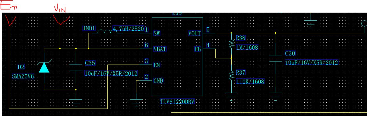

Dear TI
I have a problem using TLV61220
1) Design :
            Input Voltage : 4V
           Output Voltage  : 5V
2) Test Result
    Vin and Enable Low(ground or open) => Vout 3.8V
    Vin and Enable High => Vout 5V
3) Question
   Could you help me this problem ? in case Enable is Low, why Vout is 3.8V?
