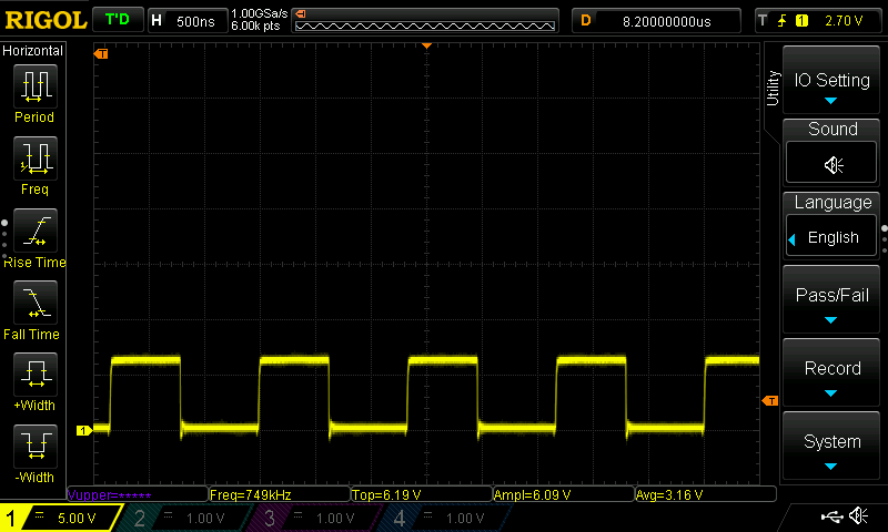

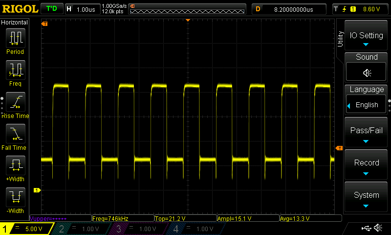

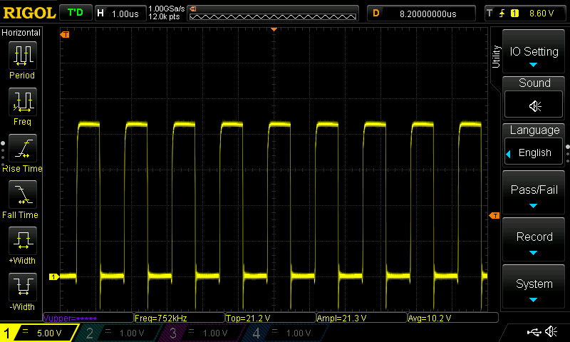

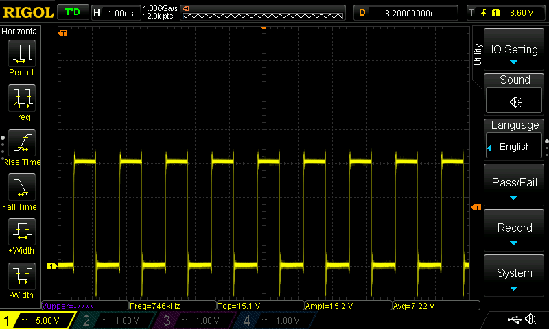

What I'm seeing is that the Charger IC isn't properly driving the hi and lo MOSFETs that control the charging voltage to the battery.
Under working conditions we see a nice square waves on these pins at roughly 735kHz (including btst and phase too).
Working LoDRV:
Working Bootstrap:
Working HiDRV:
Working Phase:

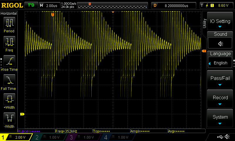

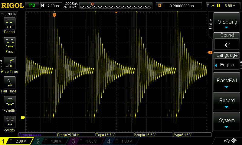

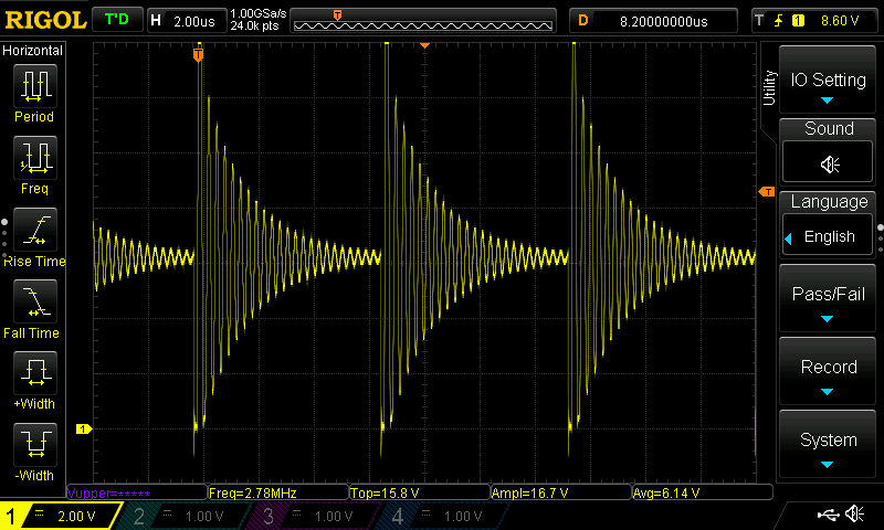

Now, when we compare the working to the non-working charger ICs, we see massive ringing and no square waves generated at all.
Failing Bootstrap:
Failing HiDRV:
Failing Phase:
Does anyone have any insight into what might have caused our Charger ICs to start ringing instead of charging our batteries properly?

  • The normal waveforms were shown the typical inductor CCM operation.
    The "non-working charger IC" waveforms were shown the inductor DCM operation.
    If the battery voltage increasing or setting a lower charge current, you could see CCM waveform changing to DCM waveform. So, both CCM and DCM waveforms are OK to our converter.
    Please give detail about "non-working charger IC". For example: charge current regulation doesn't work or charge voltage regulation doesn't work...
    1. Please check the battery voltage and charge voltage/current register value. If the battery is fully charged, the converter could have DCM operation.
    2. Measure the Vsrp-srn to see if it reaches the limit or not.
    2. Measure the Vacp-acn to see if it reaches the limit or not.

  • Thank you for the detail info. It can speed up the debug work.
    The "non working" board switching waveform shows
    1. LoFET was always turned on first.
    2. Less 10us between two LODRV refresh pulses.
    To me, a. the converter is not latched off; b. refresh pulse too frequently;
    Please check
    1. BTST capacitor and HIFET. Is it damaged?
    2. This issue is happened after replace IC. Can we re-solder the IC to avoid the soldering issue?

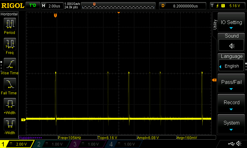

  • Thanks for working on this with me!
    Here is the waveform of the LoDrv.  I do see the periodic refresh of the Bootstrap on the lodrv.
    It does look like there is roughly 10uS between LoDrv pulses (waveform shows some ghosted captures).
    I checked and replaced both the bootstrap cap (47nF) and the HiFET (SIS412DN) and get the same results.
    I'm not equipped to replace the BQ IC.  I tried on another board and failed.  This board was working when it was initially assembled, so I'm not sure what has changed.  I also have 2 other boards that are exhibiting this same behavior.  Whereas roughly 10 are still working correctly.
