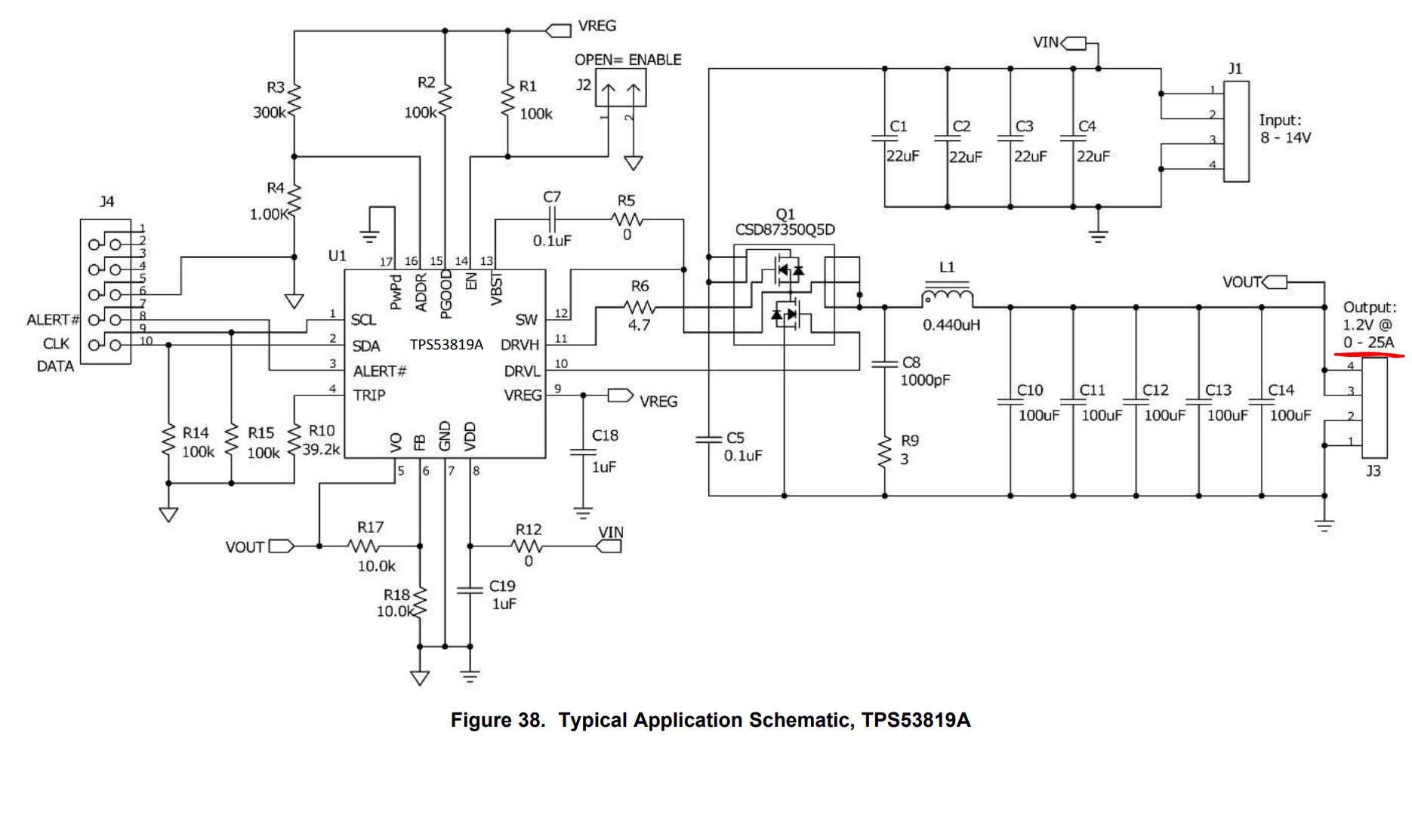

It shows that the TPS53819A can support up to 40 amps. However, on this image (attached) in the datasheet it shows 0-25A as well on all of the efficiency curves.
I just wanted to be sure this part supports 25A.
Also what is the advantage (if any) to using LM27403 instead of this part?
