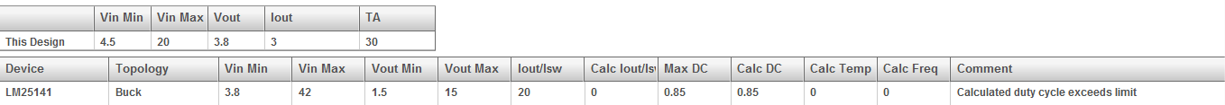

Hi Team,
We would like to simulate LM25141 at the following conditions.
However, we can’t simulate and the following screens are displayed.
[Conditions]
-VIN=4.5V(min) to 20V(max)
-VOUT=3.8V
-IOUT=3.0A
-Fsw=440kHz
I guess that the minimum OFF time is not appropriate if the default switching frequency of WEBENCH is 2.2MHz.
-According to datasheet, minimum OFF time is 100ns(max)
-According to this conditions, minimum OFF time is around 68.1ns
Is my understanding correct?
If yes, could you please improve the default switching frequency of WEBNECH?
