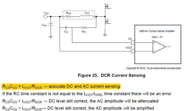

We would like to use the DCR current sensing at the following conditions.
I calculated “current limit at DCR current sensing” and "CCS" and "RCS" according to the datasheet.
[Conditions]
VIN=4.5V to 20V
VOUT=3.8V
IOUT=3.0A(max)
Fsw=440kHz
LOUT=6.8uH (DCR is 18.4mohm)
(Current limit is around 3.88A at DCR current sensing according to calculation (12))
[My result]
-Current limit is around 3.88A
-CCS is 3.3uF
-RCS is 100ohm
*“LOUT/RDCR” is 0.000369 and “CCS*RCS” is 0.00033.
So “CCS*RCS” is nearly equal to “LOUT/RDCR”.
Is my understanding correct?
Could you please let us know if you have any concern and recommended other value?

    Yes, your understanding is correct.  The objective is to choose Rcs and Ccs, so RcsCcs=Lout/Rdcr.
    As designed I also calculate:
    Rcs*Ccs=.00033
    Lout/Rdcr=.0003696
    The percent difference between these two values is approximately 11%.  I would recommend changing Rcs to 110 Ohm; then, Rcs*Ccs=.000363.
    As the datasheet mentions, the PCB layout will be critical to ensure noise and DC errors do not corrupt the current-sense signals.  When you begin layout, make sure to follow the PCB layout guidelines.
