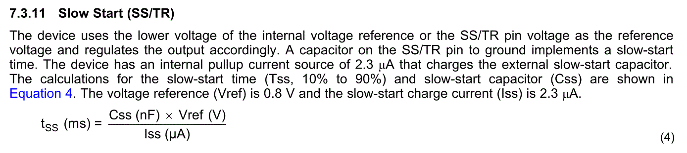

Please tell me the internal current ISS for charging the SS capacitor of TPS54620.
What is the min / max of Iss?
Also, I think slow start time can be obtained by the following formula, but how long is the minimum time?
