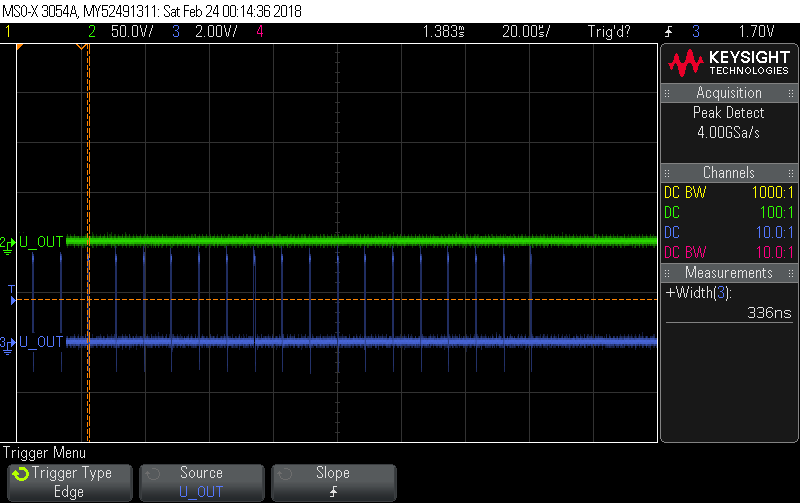

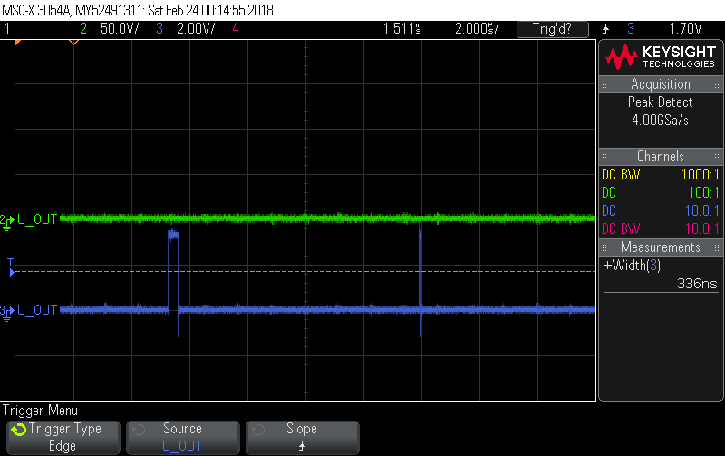

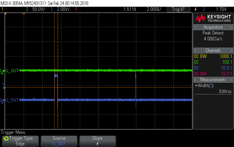

    But I get some Screen shots now. I Looks like, that only the last puls emitted is too short. At very light load there will be only one pulse followed by a longer interval without pulses and this results in a sequence of too small pulses I detected before.
    Here is an overview about whats happen when I set error o -1- The lable 'U-Out' is wrong, sorry for that.
    Here you see the n-1 pulse which has the width of about 336ns and the last pulse which is smaller.
    And here is the very last pulse, which is 52ns ==> too short.

  • Gerhard,
    What did you put on MIN_DUTY_HIGH? What is the minimum pulse width you need?
    I am not clear what exact you want to achieve with this minimum duty register. If you want the minimum duty is always higher than a certain value, you can use
    Filter Output Clamp Low Register (FILTEROCLPLO).
    Bosheng

  • Gerhard,
    I just tested MIN_DUTY_LO and MIN_DUTY_HI registers, if you put the same value for them, it will do what you need: the pulse generation stops if the filter output is lower than this value and starts again, if the filter output is higher than this value. If you put different values on MIN_DUTY_LO and MIN_DUTY_HI, then the minimum duty is controlled by MIN_DUTY_HI.
    Can you use the same value for MIN_DUTY_LO and MIN_DUTY_HI ?
    Bosheng
