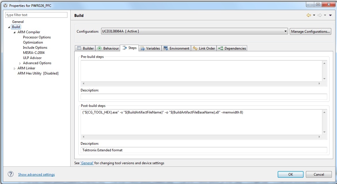

    I'm using UCD3138PFCEVM-026.Making x0 File fail after I change the default IC from UCD3138 to UCD3138064A . The Log shows below:
The ".out File has been generated ,however the post-build" failed ,why could this happen ?
CCS Version :CCS 6.2

<Linking>
'Finished building target: PWR026_PFC_UCD3138064A.out'
'Tektronix Extended format'
("C:/ti/ccsv6/tools/compiler/ti-cgt-arm_5.2.5/bin/armhex.exe" -x "PWR026_PFC_UCD3138064A.out" -o "PWR026_PFC_UCD3138064A.x0" -memwidth 8)
makefile:200: recipe for target 'post-build' failed
process_begin: CreateProcess(NULL, (C:/ti/ccsv6/tools/compiler/ti-cgt-arm_5.2.5/bin/armhex.exe -x PWR026_PFC_UCD3138064A.out -o PWR026_PFC_UCD3138064A.x0 -memwidth 8), ...) failed.
make (e=2): 系统找不到指定的文件。
gmake[2]: [post-build] Error 2 (ignored)
**** Build Finished ****

  • The PFC codes for all devices have this issue with some versions of CCS.  You need to right click on the project name, then select Show Build Settings->Build->Steps
    In the Post=build steps window, you will see this:
    ("${CG_TOOL_HEX}.exe" -x "${BuildArtifactFileName}" -o "${BuildArtifactFileBaseName}.x0" -memwidth 8)
    Delete the parentheses on the outside, so it looks like this:
    Right click on the project name again, and select Rebuild Project.  You have to use rebuild project, because the normal make type options don't pick up on changes to the post-build commands for some reason.
    Here's the screen:
  • It Works ,Thanks a lot
