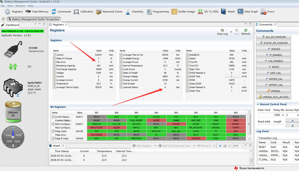

As advise by the slua334b.pdf,let the lion bat relax for 5 hours,now it over 6 hours,but the update status not change to 6,please help me,what's problem now?
here is my learning step:
1:charge full(2A current charge)
2:wait 2 hours
3:discharge to 6.4V(1A current discharge,The actual application current is 0.8A)
4:relax 5 hours

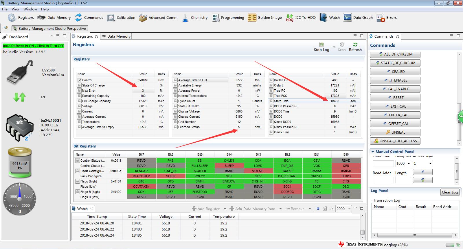

  • Thank you,discharge current change to C/5,now update status is change to 6,thanks again.
