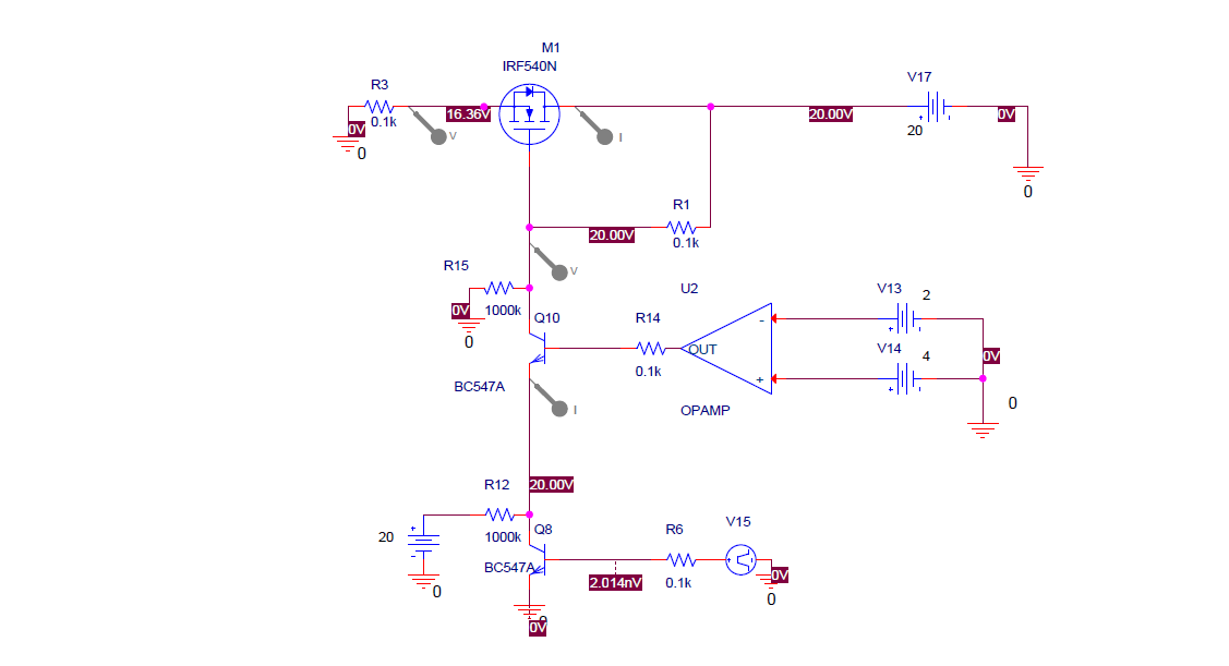

Ground short problem in power switching
I made the above circuit with the following objectives :
1. The pulse which I am applying at transistor Q8's base is being carried away to an output terminal which is source terminal of IRF540 MOSFET.
2. When the opamp's output is negatively referenced then MOSFET should be always off.
The topmost circuit branch is expected to carry a high amount of current.
I have asked some of freinds about the circut whether its practically applicable what they told me is you cannot short the ground directly to transistor and some other things.
Please specify if any mistakes is there.
P.S. I have run PSpie simulation of it and its giving expected results.
