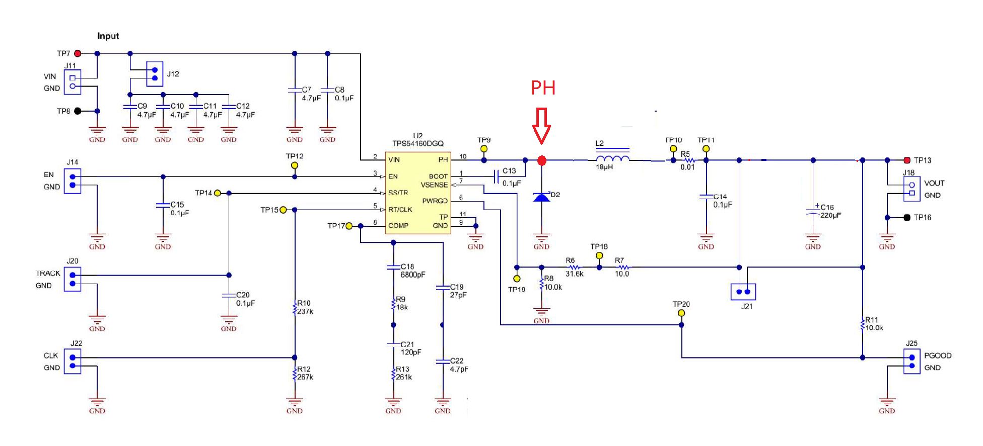

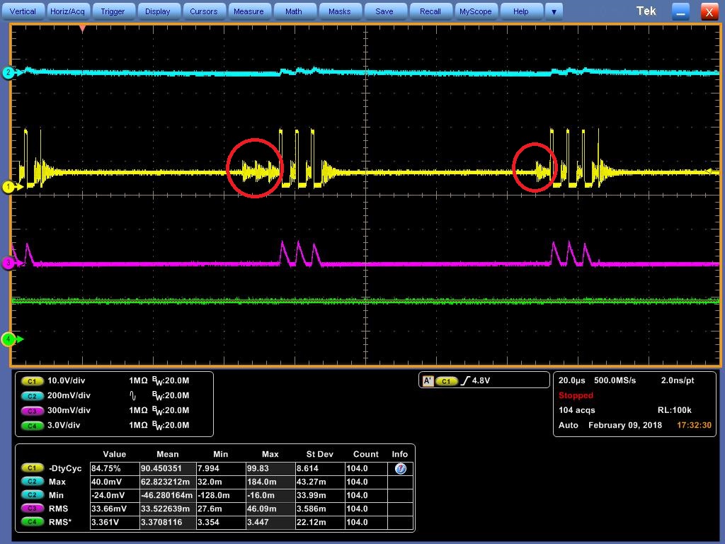

Hi team,
I meet a problem while TPS54160 in pulse skip mode.
As you can see, there are rings before conductionat PH node.  Top to bottom signals are Vout, PH, IL, PG.
Vin= 25V,   Iin=4.55mA,  Vout=3.336V, Iout=24.7mA, fs=250kHz
But in CCM mode, the signal is normal.
The schematic is as follows,
Thanks for your help.
