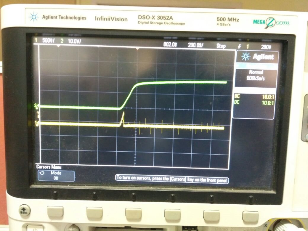

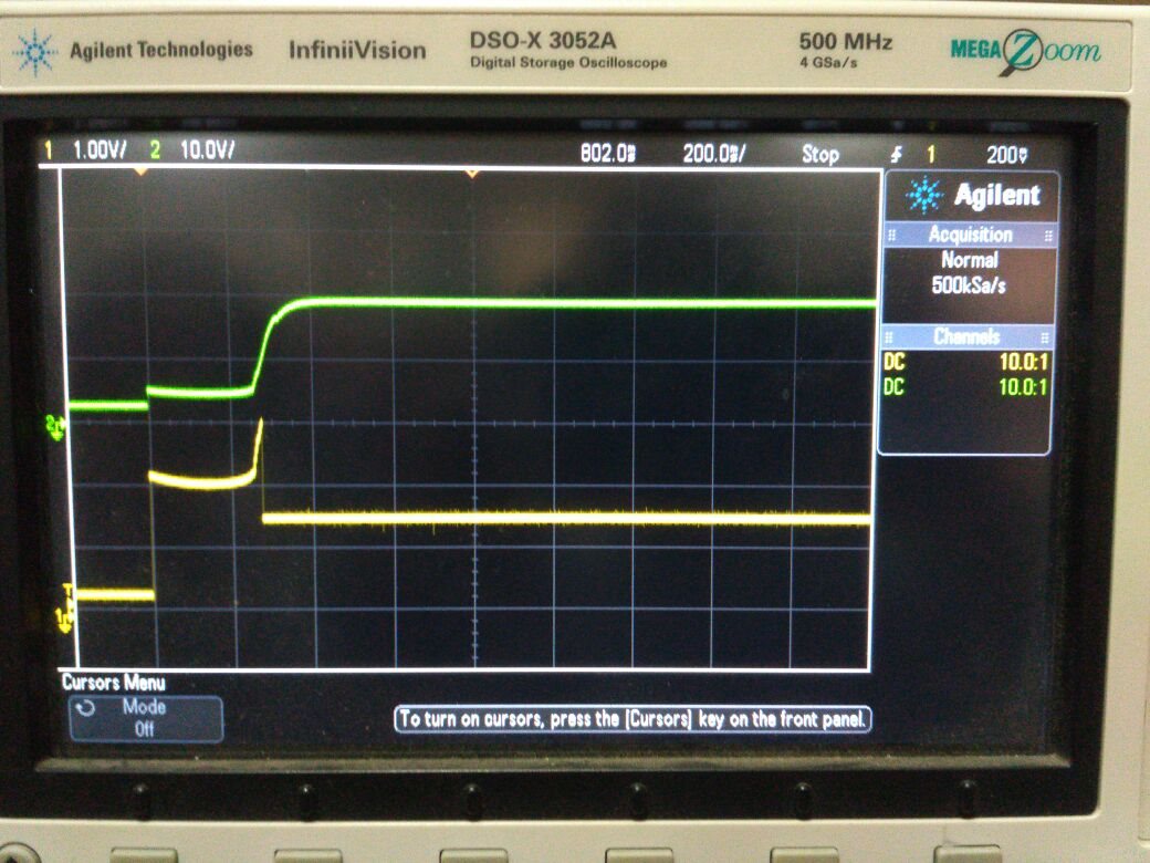

I have an LM25118-Q1 IC in one of my board. webench_project_2303220_9.pdf. the only difference I made is that I increased the input capacitor value to 13.3 uF and output capacitor value to 905.14 uF. I assembled the circuit and found that it is not working (no load other than output capacitors). I have probed the output pin and found that a noise of 0.5 v is coming. So I probed other pins and the details are as below.
EN = 13.289 V
Vin = 5.1 V
UVLO = 0.0594 V
HO = 0 V
LO = 0 V
Considering all the above voltages and referring the datasheet i was expecting a current limit situation. so i checked the output for any shorts or capacitor overload. i have removed 704 uF but couldn't find any output. The inductor is getting heated. Please suggest possible reasons and corrections. Also, please help me to identify the issue immediately.
