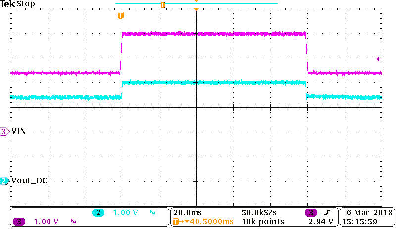

    Not unsderstand what is the following sentence mean?

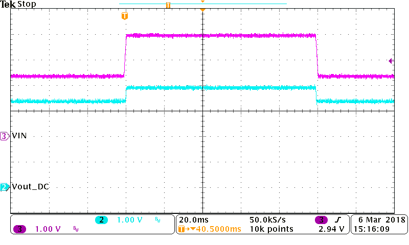

    Are there curves showing Vout undergoing the transition from regulating to supplying Vin as Vout, and vice versa?
    To clarify the sentence about “Vout undergoing the transition from regulating to supplying Vin as Vout”, it is my understanding that when Vin>Vout the boost converter switches from supplying a boosted output to passing through Vin to supply Vout. (For example, a battery that has a full charge voltage above the specified output voltage) We’d like to see what instabilities may exist in Vout when transitioning between these two modes of operation in both directions. That graph is not in the datasheet.
    David
  • We'll test it and show the waveform to you within today!
  •   When TPS61021 shift from boost mode to pass through mode, or from pass through mode to boost mode, the waveform changes smoothly.  Please check the attached waveform.
