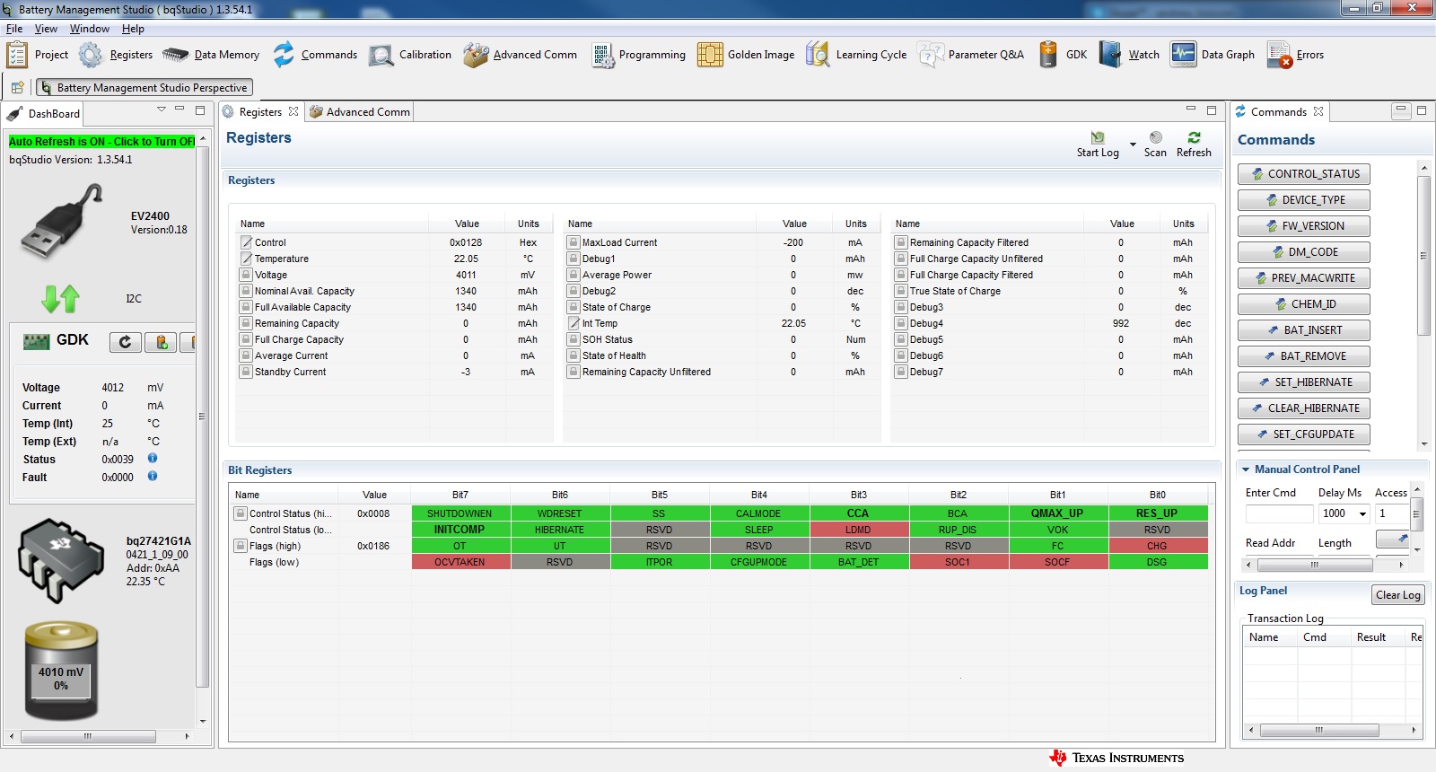

I'm trying to use the GDK with BQ27421 EVM and bqStudio.
  • First, the battery shows 0% with its voltage at 4.011V (the battery is actually close to fully charged).

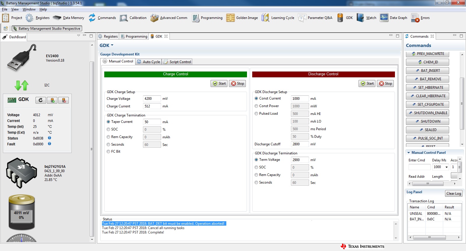

  • I click on "Start" button to charge and got the following error, "BAT_DET bit must be enabled. Operation aborted!\"

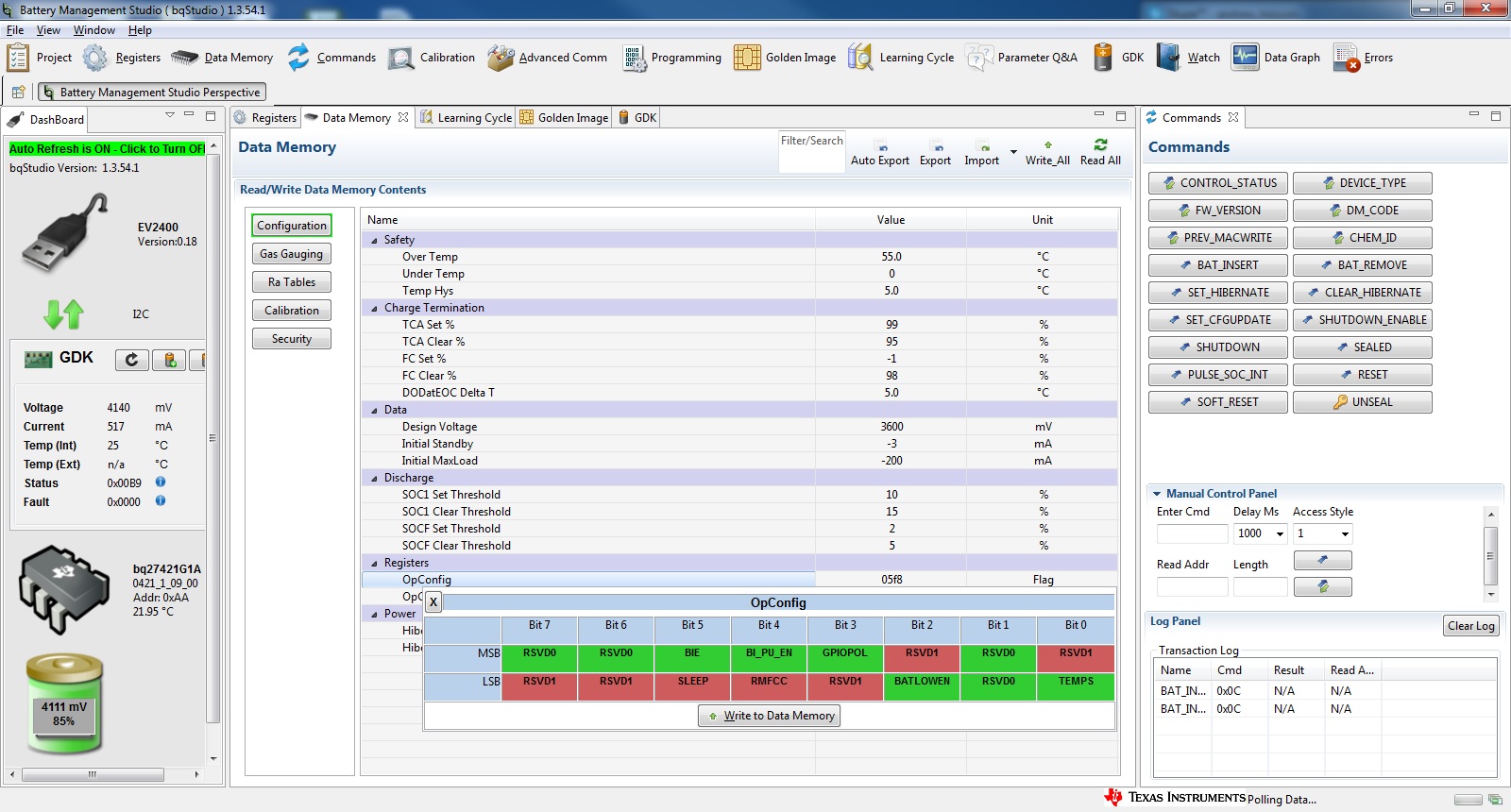

    • There is no 3rd lead (thermistor) from the battery. So how'd I force the BAT_DET bit?
