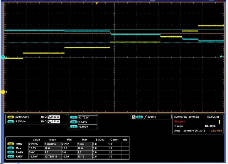

    The present input voltage is 28V Output DC (12V / 2.2A) specification.
    When the secondary side is short, the current rises to 9A and the voltage drops slowly.(CH1 = Iout, CH2 = Vout)

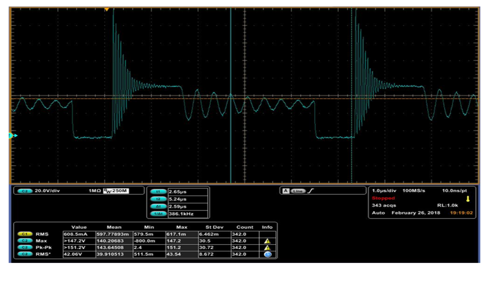

    VDS ringing occurs during normal operation
  • hi
  • the 2nd waveform shows deep discontinuous conduction mode, implying a high peak current. Please replace the power transformer with one having higher primary inductance (47uH or higher), which will help the converter in continuous conduction mode and lower short circuit current.

  • We usually do not recommend to completely delete the CS capacitor. It helps filtering out the current sense leading edge spike and prevent its effects on the normal PWM operation. You may reduce it but do not delete completely.
    By a simple calculation, it seems your current sense resistor of 20mOHm is too small. You should double that value and reduce the overloading headroom. This my reduce y our short circuit current a lot.
    The severe ringing on your Vds means an ineffective snubber. It could be resulted from PCB parasitic inductance in the path of the snubber. It becomes worse if you have a large di/dt, which seems to be the case for your 5uH transformer: a large peak current.
    If no PCB can be changed, try to increase the current sense resistor value.
