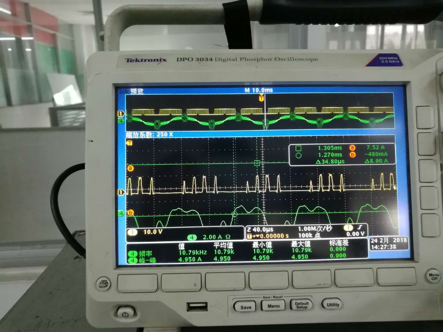

     I find UCC28019A's gate waveform seems abnormal.
     My design parameters as below:
     Vin=AC190V-265V (my test condition as AC230V), Vo=385V, Io=1.034A(total output power is 400W, and it is a motor)
     waveform as below:
     Ch1 is Gate waveform, Ch4 is input current.
     It looks like occur  in bridge rectifier's peak.

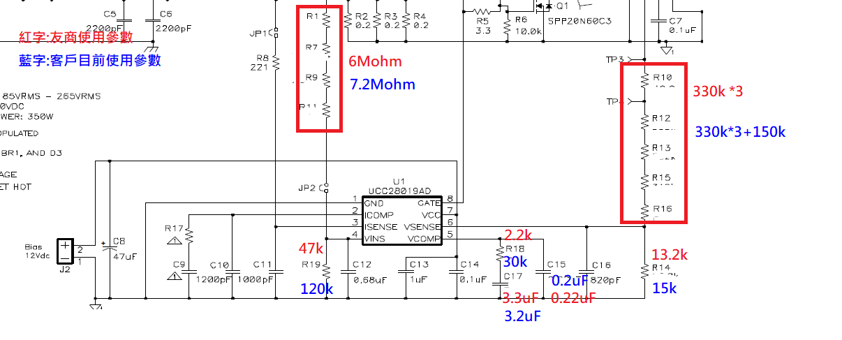

   Schematic as below:
   Schematic reference UCC28019A's datasheet Figure 26.
   now use parameters is blue.
   the red is program dealer's parameters,but there's gate waveform not abnormal.
   Is there any suggestion?
