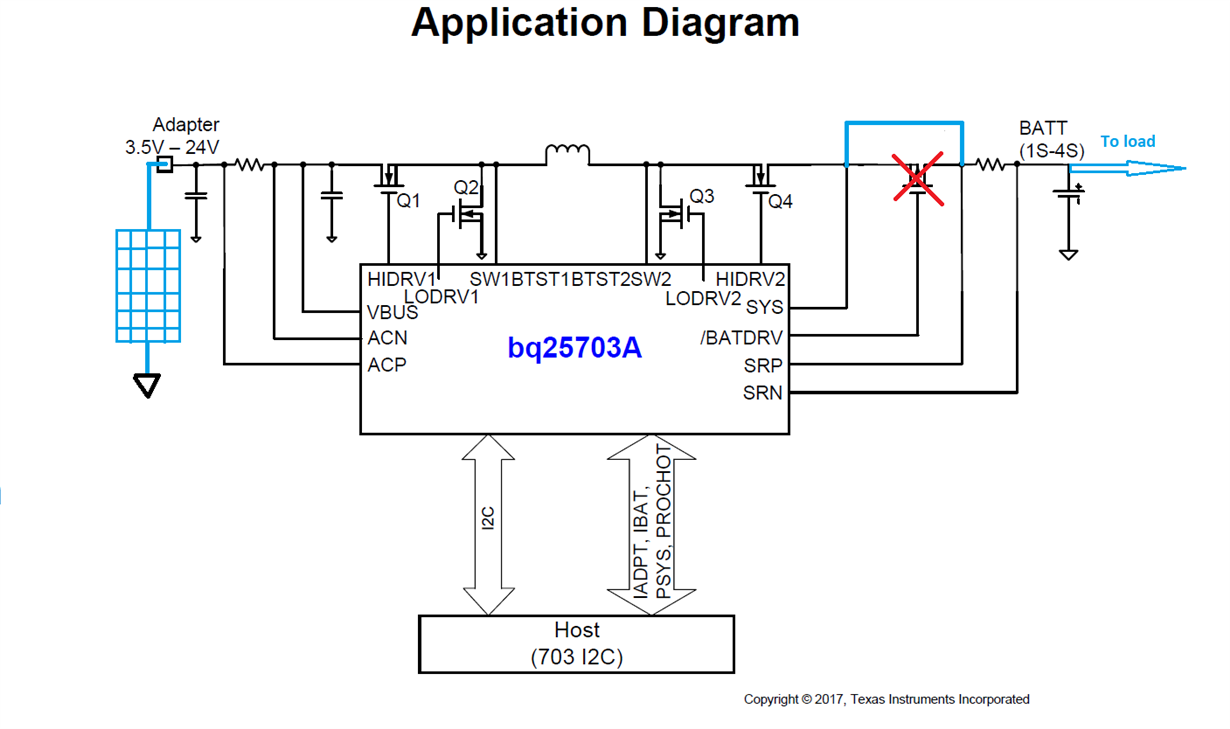

I'd like to use BQ25703A as always connected solar charger for 4S Li-ION battery. I am going to connect the load to the battery output, omitting VSYS branch. I am going to take care of the battery under-voltage issue in the pack's BMS, so I don't need linear regulation provided by P-MOSFET.
Can I remove the BATDRV MOSFET, as follows :
Thanks.
  • Even the charger doesn't have the system load, bq25703A charger cannot save the system capacitors to keep output stable.
    Even the battery pack can take care of the battery under voltage condition, bq25703A cannot save the BATFET to avoid output OVP at charge disable condition (battery fully charged or input source plug-in without charge enable command).
    So, If I am moving the output caps to the BAT branch instead of the VSYS branch I am solving that issue ?
    Can you elaborate on that, because I can't see the direct dependence of BATFET presence and OVP at charge disable condition
  • If charge is disable, converter regulates the VSYS pin voltage about 160mV higher than VSRN. If without BATFET, the VSYS is almost short to VSRN, VSYS cannot meet VSRN+160mV set point. So, converter will keep pushing VSYS high until trigger OVP or other protection.
    Since the BATFET is needed, bq25703A needs enough VSYS capacitors to keep converter stable.
  • In case I'd like to connect the load directly to the battery rail, and not to use the VSYS output ( I'd like to draw more than 6.35A from the battery ) I just can use a small P-MOSFET to regulate the VSYS to the correct level . Am I correct ?
  • The P-MOSFET should be able to take care the maximum charging current.
    Make sure the system load current is much smaller than the pre-charge current when the battery voltage is lower than Vsys_min.
