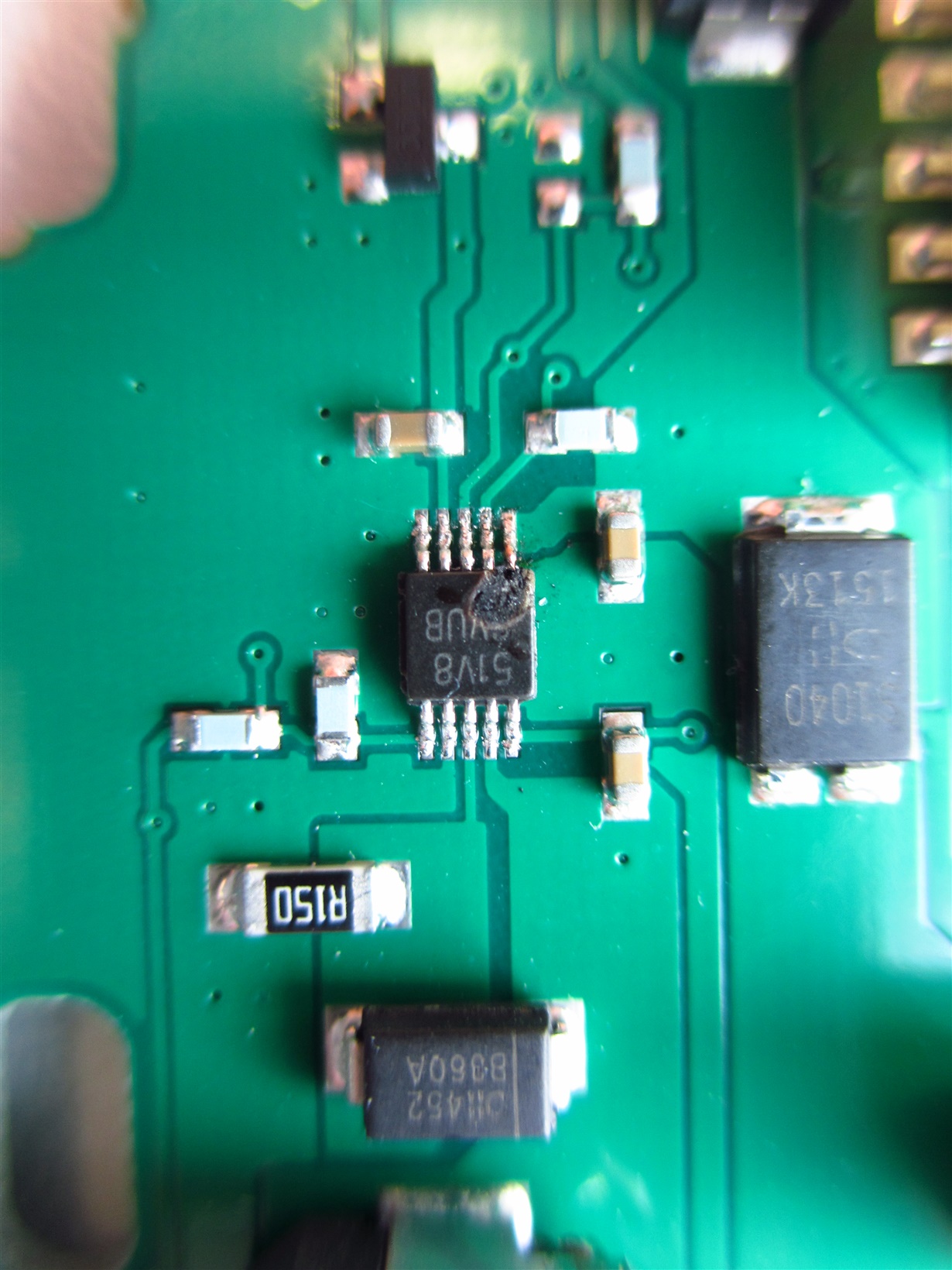

I have an application where I use the LM25011 to charge a 3F capacitor and to hold the voltage at about 19V when the charge is finished.
Vin = 24V (+/- 10 %)
During the charge, the regulator works in current limit (ajusted at 1A).
The Problem we have is that sometimes a failure of the LM25011 occurs. The charging of the capacitor doesn't works and you can see a burn mark on the package of the LM25011 (see Picture attached).
Up to now, this failure occured only sometimes during the final test of our production line.
At the Moment, I couldn't reproduce this failure by doing tests in the laboratory. I could just mesure a short circuit between the SW-pin and GND. So I presume that the pre-charge circuit ist defect.
Do anyone of you have an Idee why this failure occurs and why only sometimes?

  • Hello Simon,
    Looks like Pin 1 side of the IC is destroyed, even though you have a short between Vsw and Gnd? Can you confirm? Also can you post the schematic as I did not see the attachment?

  • 1641.Schematic.pdfHello David,
    Yes. I confirm that we have a short between Vsw and GND and that is the case with all defected LM25011.
    I also measured the resistance between Vin and Vsw. In some cases, you measure about 300 Ohms, in other cases a little bit more (for example 2k2, but it isn't a whole stable value). I did the measurements without other parts around the LM25011.

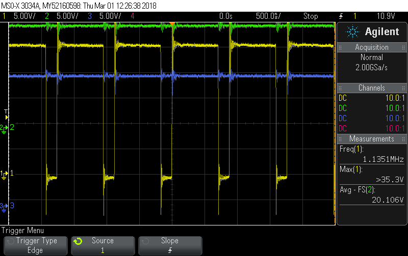

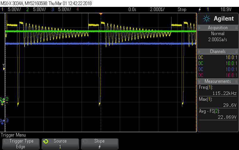

    I don't have the scope capture of the inductor current at the Moment. But I can already show you the waveforms of the switch voltage when the regulator works in continuous (during charging) and discontinuous current mode (wenn the 19,6V at output are reached) (see attached files).
  • The scope capture waveform's look very stable.
    The inductor is ISAT is specified to be more than adequate.
