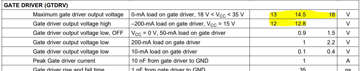

I am working on AC/DC converter using UC3854 IC. I have a problem in GATE DRIVER pin.It is connected to source of Power MOSFET with 5 ohm 10 W resistor.once the input supply is turned on the resistor was blown out. What might be the problem for this and how to rectify it?
My power rating is 500W.
Thank you
    Thank you for your interest in UC3854. I think the problem might be the power rating of the 5ohm resistor is not enough to withstand the high current drive output. Looking at the maximum ratings on the datasheet the power output of the GT DRV will be between 12.8W-18W worst-case, I suggest increasing the power rating of this resistor should solve your problem.
    Another thing to look here is what is the size of your resistor eg: a 0402 will have more stress on the package and replacing it with say 1206/0805 will lower down the thermal stress.
    I hope this answers your question.
