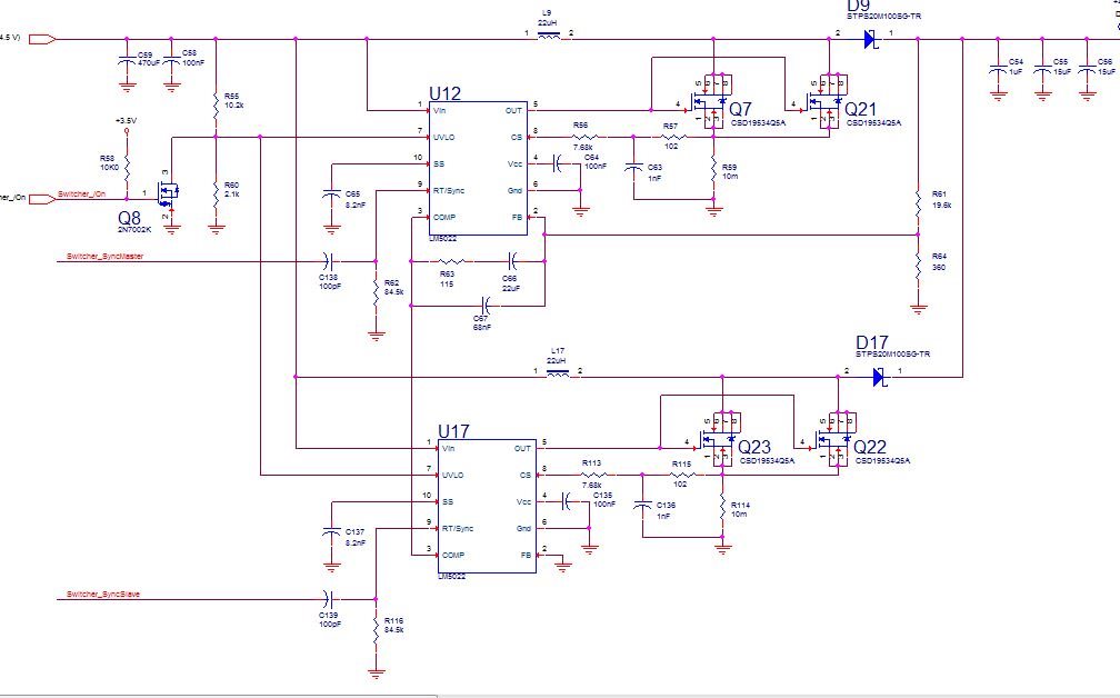

    You can tie the outputs together, but make sure only the master one controls the Vout regulation, and for all slaves, ground the FB pins and tie their COMP pin to the master's COMP.

  • OK, so is the following topology correct?
    And for the sync signals, would the following be correct. The LM5022 as configured has a clock of around 200KHz. So If I produce a clock of say 250KHz and sync the master on the rising edge, and the slave on the falling edge that should work? Using the correct pulse width of 50 to 150nS and peak voltage level (greater than 3.8 V) of course.
  • The connection is correct.
