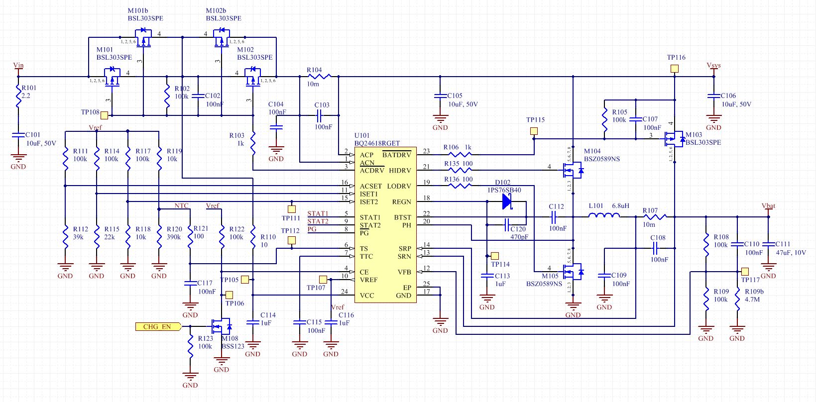

I've got the same problem: the body diode of the input MOS reduces the Vcc at startup below 4.7V. It could be the reason why my charger dosn't start with a standard 5V input 8e.g. from USB).
Is there any way to fix this issue?

    Can you please show your schematic? and your measurement?
    Have you tried using the same FET that is used on our EVM?
  • Hello Jing,
    here is the schematic:
    When Vin=5V, the Vcc is a little below 4.7V (Vcc=4.6V). When Vin=5.1V, Vcc=4.7V and charger starts to charge the battery.
    The problem is that, accordingly to USB specifications, Vin can also be as low as 4.75V. In my design I've chosen the BQ24618 because it is declared to work with a minimum Vin of 4.7V and to be "USB-friendly".
    There are no EVB for BQ24618. If you are asking about the BQ24617 EVB (but BQ24617 has a minimum Vcc of 5V, so it has a specific difference on parameter we are discussing about), no, I'm not using the SI4401DY pMOS, but the BSL303SPE.

  • What is the battery voltage you are testing with? Also how are you connecting the battery?
    To begin charging, VCC must be higher than SRN by at least 500 mV (otherwise, the device will be in sleep mode). TI recommends an input voltage of at least 1.5 V to 2 V higher than the battery voltage, taking into consideration the DC losses in the high-side FET (Rdson), inductor (DCR), and input sense resistor (between ACP and ACN), the body diode drop of RBFET between VCC and input power supply, and battery sense resistor (between SRP and SRN).
    Therefore, there are a lot of add on resistance that our charger cannot control. Selecting FET with lower Rdson, lower DCR inductor, and shorten the trace between input to IC, and IC to the output will help to reduce the resistance on the high current path.

  • Sorry Jing,
    in my previous post I made a mistake: Vin is more than 600mV higher than SRN, but Vcc not (because of the body diode of M101).
    So maybe you are right: when the battery is high, the BQ24618 does not exit the SLEEP mode:
    • battery full charge voltage (i.e. SRN voltage): about 4.2V
    • Vin minimum voltage: 4.75V (USB)
    • Vcc minimum voltage: 4.3V (depends on MOS body diode)
    • SLEEP rising voltage (Vcc-SRN): 0.1V, well below 600mV (i.e the SLEEP rising threshold)
    How can the BQ24618 be "USB friendly"?
    I've checked my proposed solution of a schottky diode in parallel to the M101 body diode and the situation is much better. The problem is not completely fixed, but it is restricted to only worst cases.
    What do you think about such workaround?
    Is there anothe solution? Is it possible to disable the SLEEP mode?
    Thank you very much
    Matteo
  • For 5V USB application, you can remove the reverse blocking FET. Instead you can add a zener diode at the input for reverse plug protection.
