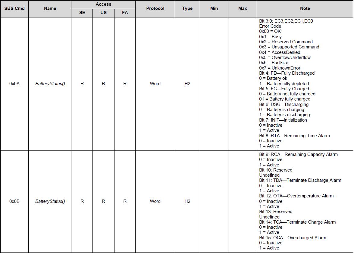

Hi Sir,
My project use bq28z610 gauge in android device(linux kernel 4.4). I know bq28z610 gauge driver is bq27xxx_battery.c, but bq28z610 can not met some battery configuration.
So there are some question as below:
1.  In bq27xxx_battery.c, I need to modify configuration flags bit of battery status for definition marco, but I can't match some marco flags bit of battery status with bq28z610 datasheet ( EX : BQ27XXX_FLAG_SOCF , BQ27XXX_FLAG_SOC1, BQ27XXX_FLAG_OTD, BQ27XXX_FLAG_OTC, BQ27XXX_FLAG_UT)
Could you tell me what flags configuration is correction for bq28z610 datasheet.
/* BQ27XXX Flags */
#define BQ27XXX_FLAG_DSC       BIT(0)
#define BQ27XXX_FLAG_SOCF      BIT(1) /* State-of-Charge threshold final */
#define BQ27XXX_FLAG_SOC1      BIT(2) /* State-of-Charge threshold 1 */
#define BQ27XXX_FLAG_FC                BIT(9)
#define BQ27XXX_FLAG_OTD       BIT(14)
#define BQ27XXX_FLAG_OTC       BIT(15)
#define BQ27XXX_FLAG_UT                BIT(14)
#define BQ27XXX_FLAG_OT                BIT(15)
[bq28z610 datasheet ]
2. I need to add bq28z610 i2c register of battery information, but I could not find out NAC(Nominal Available Capacity) register for i2c communication.  it use in getting battery information of nominal available capacity by received POWER_SUPPLY_PROP_CHARGE_NOW.
Could you tell me what is NAC i2c register on bq28z610 datasheet.

[The below is added for referece bq28z610 datasheet]
/* [Pegatron][Terry_Tzeng@pegatroncorp.com][2018/02/07] Add BQ28Z610 gauge register - Begin */
static u8 bq28z610_regs[] = {
        0x00,   /* CONTROL  */
        0x06,   /* TEMP     */
        0x28,   /* INT TEMP */
        0x08,   /* VOLT     */
        0x14,   /* AVG CURR     */
        0x0A,   /* FLAGS    */
        0x16,   /* TTE      */
        0x18,   /* TTF      */
        0x1C,   /* TTES     */
        INVALID_REG_ADDR,   /* TTECP - Time-to-Empty at Constant Power  */
        ??,   /* NAC - Nominal Available Capacity */
        0x12,   /* FCC      */
        0x2A,   /* CYCT     */
        INVALID_REG_ADDR,   /* AE - Available Energy    */
        0x2C,   /* SOC      */
        0x3C,   /* DCAP     */
        0x22,   /* AP       */
/* [Pegatron][Terry_Tzeng@pegatroncorp.com][2018/02/07] Add BQ28Z610 gauge register - End */
static inline int bq27xxx_battery_read_nac(struct bq27xxx_device_info *di)
   int flags;
    if (di->chip == BQ27000 || di->chip == BQ27010) {
        flags = bq27xxx_read(di, BQ27XXX_REG_FLAGS, true);
        if (flags >= 0 && (flags & BQ27000_FLAG_CI))
            return -ENODATA;
    return bq27xxx_battery_read_charge(di, BQ27XXX_REG_NAC);
