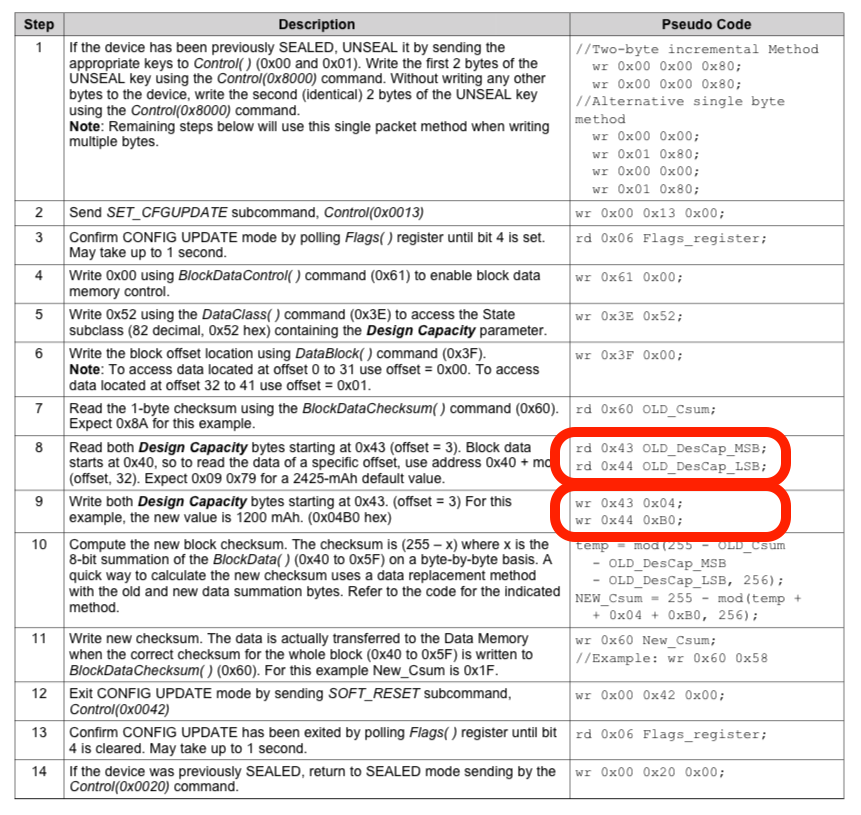

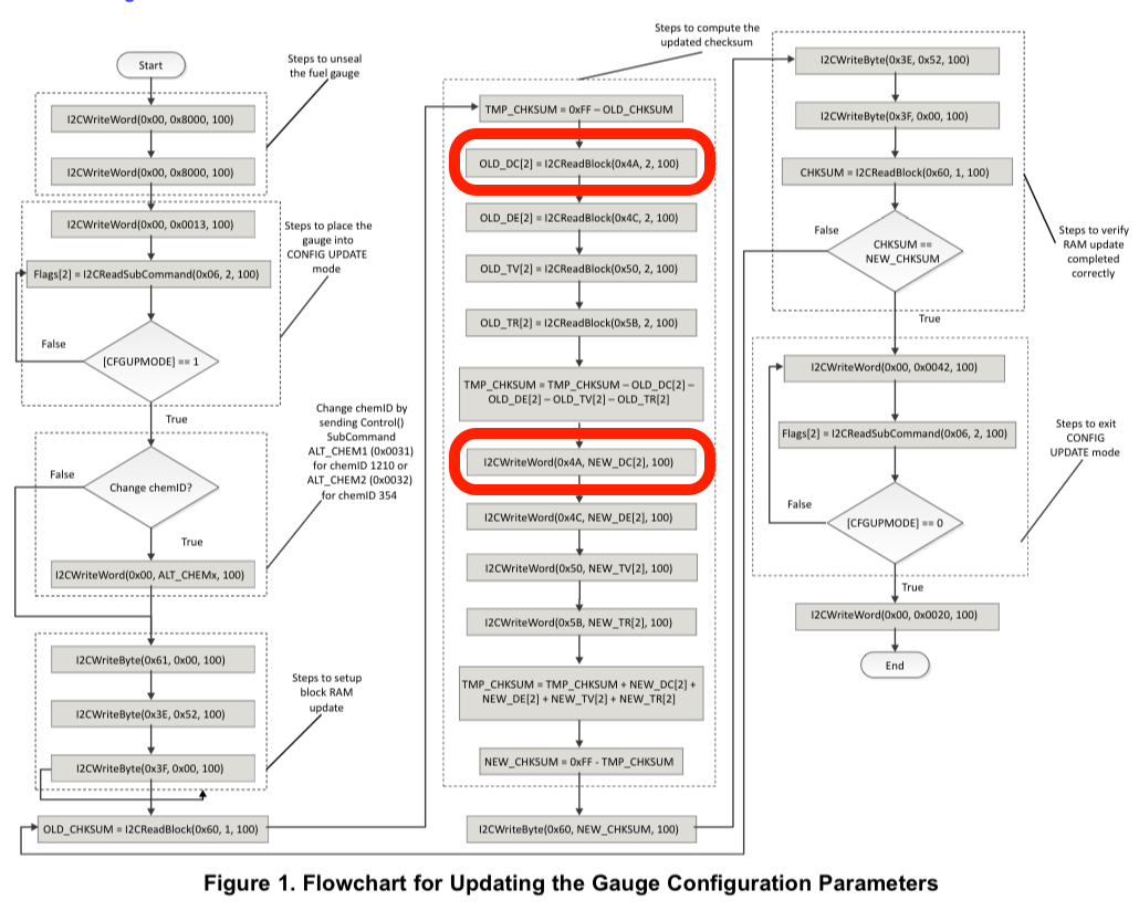

    In section 3 in the QSG; reading the design capacity (as an example) is done by reading register 0x4A. In section 3.1 in the TRM however, the design capacity is read from register 0x43. Is this a typo in the QSG or am I missing something?
  • Hi Oscar,
    The TRM should be the correct one. Pls check it for confirmation.

    I checked through the QSG to see what effect it had, and a curios/serious side-effect is that it changes "Voltage at Charge Termination". For us, it meant changing voltage at charger termination from the default 4190mV to (an unreachable) 4242mV. For the sake of completeness, I'm including a table of the incorrect addresses in QSG as well as some screenshots.
    We're testing it as we go, but I think the accidental modification of the V at CHG term register was the culprit to never reaching 100% capacity.
    Design parameter QSG address Correct address QSG address modifies
    Design capacity 0x4A 0x43 Terminate voltage (LSB) + Undefined
    Design energy 0x4C 0x45 Undefined
    Terminate voltage 0x50 0x49 Undefined
    Taper rate 0x5B 0x54 V at CHG term (LSB) + AVG I Last Run (MSB)
