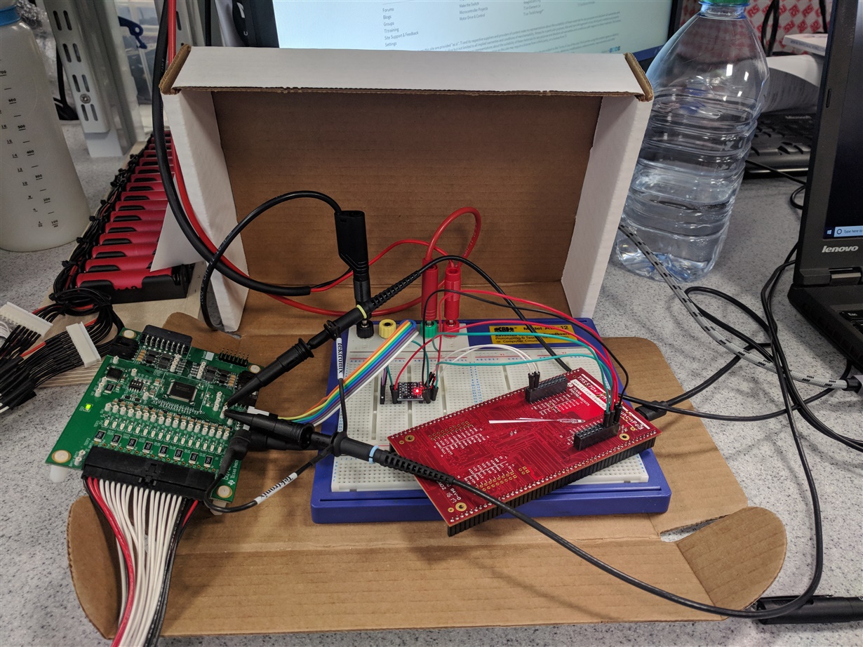

    Could you share a picture of your setup?
    If possible, I would also put a logic analyzer on the pl455 RX pin to make sure it is receiving the data that you think it is. That will be the biggest help.

    Here's a picture of my setup:
    The power in the picture is coming directly from the TMS board, not from the banana connectors.

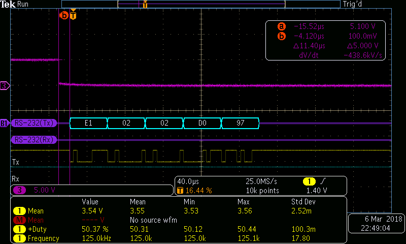

    I put a logic analyser on the TX and RX pins (As labeled on the silk screen), and a probe on the Wakeup line as well (purple).
    I intended to send the hex codes: {0xe1, 0x02, 0x02, 0xd0, 0x97}
    This correlates with what the scope reads (MDO3024 scope).
    The scope is setup with 250kbps, 8 data bits, no parity, for UART mode it required inverted polarity (HIGH = 1).

    The wakeup line sends a 24ms pulse (using the supplied function), which gives an actual 19ms pulse.
    When trying to trigger of the RX line (as per silkscreen) the scope doesn't trigger, implying that nothing is transmitted back to the TMS board.

    I decided to check the the schematics to see if I had wired the communications interface correctly - After I made sure that was the correct way around I re-ran the code. So the reason why the code wasn't doing what I thought is I only have 1 slave board attached but the example code seems to be written for 3 boards.
    So it was forever getting stuck waiting for a response. Using the logic analyser I found that it had been responding to some commands, just not the ones I was checking with break points because it was trying to index boards that didn't exist.
    Thanks for your help and pointing to use the logic analyser.
