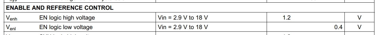

Hi Expert,
Could I have the Max value for TPS61175 Venh? Datasheet only provide Min, we require Max set Max input voltage.
Thanks.
Zhou
Hi Expert,
Thanks.
Zhou
maximum voltage on EN pin is 20V.
