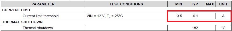

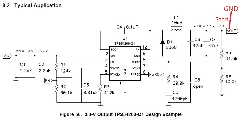

My customer wants to design a circuit that uses a TPS54260 to output 12V at 24V input.
When Vout is shorted to GND, It must check to occur problem in automotive system.
If GND and Vout are shorted and current exceeding the current limit(in redbox below table) flows, will the FET be continuously turned off by the internal current sensor?
Are there any additional measures to protect the TPS54260 and peripheral circuits (other systems connected to Vin) when a short circuit occurs?
<The image below is captured from the datasheet to help you understand.>
