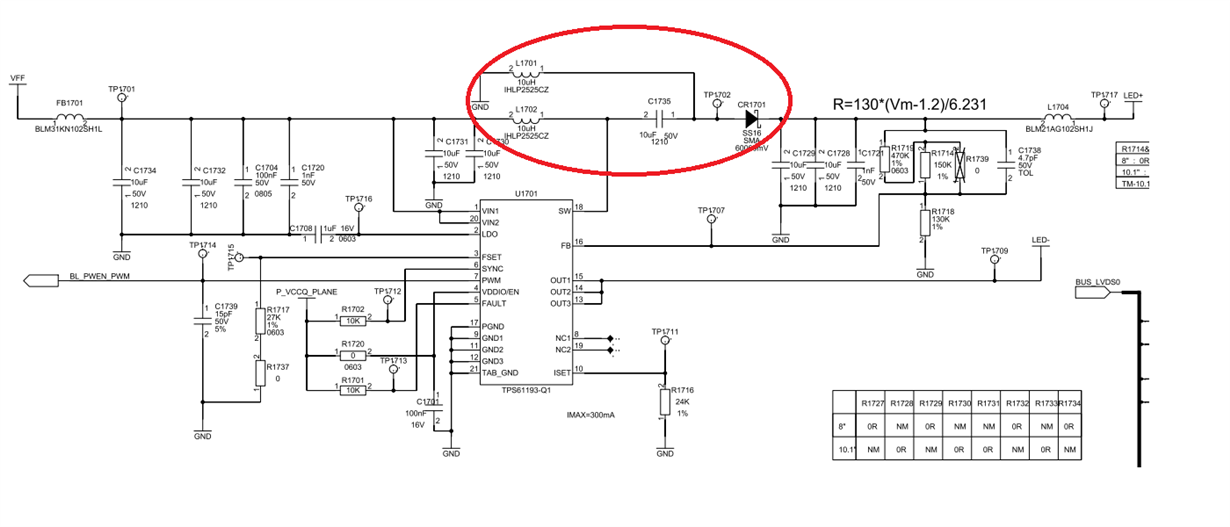

Dear sir:
The schematic is below,I want to know the function of the circuit diagram marking the red circle.What is the reason for the short circuit of the anode of diode to the ground?
thank you!
Dear sir:
thank you!
This is circuit for SEPIC mode topology. You can refer to typical application section 8.2.2 for more details on this.
