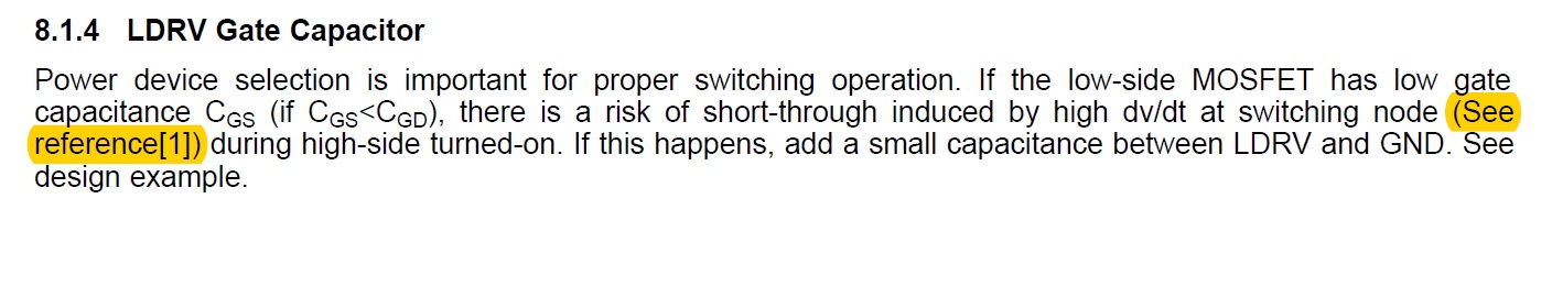

HI Sir
I don't see the reference[1] in the datasheet other place
Could you kindly help to provide it ?

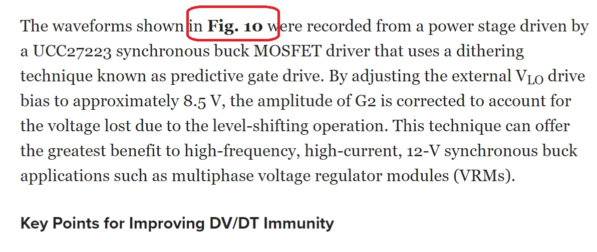

Hello Kai,
There was no other link in the datasheet. I got this link from the datasheet from section 11.2.3. It addresses DV/DT Immunity.
Hope this helps?
