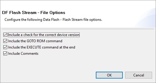

Hi there
I created a 'flash filestream' file with all default parameters of a brand new bq27750 from an EVM.
My goal is to reset all defaults of the bq27750 I have soldered into my actual HW (that is not possible to connect to bqStudio).
The flashstream commands ('W', 'C', 'X') are easy enough to implement, and so this seems like a good way forward.
However, the flashstream file output by bqStudio corrupts my device. I know what you are thinking : "he didn't implement the commands correctly".
I am certain they are correct given their descriptions here : http://www.ti.com/lit/an/slua801/slua801.pdf.
That and the fact that, after programming, some of the parameters are correct defaults (i.e. most of ADVANCED CHARGING ALGORITHM block are correct excluding 'termination' config), and some not (PROTECTIONS block are mostly now garbage) tells me the stream handling is good, but the stream is not.
So then, how to move forward?  I have a corrupt device. SREC...???
I know how to read SREC files, but the ROM commands of the bq27750 are top secret.
I can glean some ROM commands from the flashsteam file, but not all.
bqStudio has an SREC to Flashstream conversion function (yes, its hidden, but somehow the function appeared for me at a certain point, so I used it).
I convert the 'bq27750_v0_04_build12.srec' file to a bq.fs file, and I can see with ROM commands '0F' which correlate with the SREC data.
The precursor to these commands however, are a bunch of further ROM commands, and executing them doesn't get past the fourth line : 'W: 16 09 02 00' ... the bus just times out.
So it would appear that bqStudio strikes again.
My question : how can I un-corrupt my device? My preferred method would be to execute the SREC file, but naturally I would need to use the ROM mode for this.
Here is the ROM code that is generated by bqStudio. Maybe someone can 'fix' it so that I can execute it.

  • Hello Eugene,
     if you can communicate with the device, chances are you should be able to program the default srec which you can get from the product folder of thee device. Program the srec  using bqstudio. If you are unable to program it, then you will need to replace your chip.
    Can you confirm what adapter you are using for programming? EV2300 or EV2400? What firmware version is on the adapter which you are using? if you are using the ev2300 and you have version 3.1c, that is likley the cause of the corruption. update to 3.1m or 3.1r.  If you are programming using your host and the device is getting corrrupted, here is what i suggest you do:
    Extract the flashstream file using bqstudio, then make sure you are able to program the flash stream back on the device using bqstudio. If everything works fine and then the device gets corrupted when using your tool, then it means something is wrong with your programming sequence and has to be troubleshot.
    Hope this helps.

  • Hello Onyx
    I used the EV2400 to create the flashstream file.
    I can not use bqstudio to program my device, but I can use bqStudio to program the EVM.
    That seems to work.

  • hello Eugene,
    If you are able to program the EVM with the flashstream file extracted using bqstudio and the board is functional, then something is definitely wrong with your programming sequence. Can you attach the flash stream file which you are trying to program. One thing is have seen with customers is that if the have commands in the flash stream file with long bytes, eg 32 bytes, the run into problems programming that file on their device using their tool although bqstudio would successfully program that same file. What i would suggest your do is check your file and if you see you have long bytes after a command, use bqstudio to break up the the command into smaller groups of commands. To do that, go to golden image plug in, and then before extracting the file click options, then limit pack size and the reduce it to less than 10.
    if that still doesn't help, i would suggest getting an i2c bus sniffer and sniff the evm comm lines to see how bqstudio is writing the commands to the gauge and then do likewise.
    Also, see attached sample code in c that parses the flash stream file on a similar device device.

  • Hi Onyx
    Attached the file bqStudio creates. 'Big' ROM commands are 21 bytes (including address)...so maybe borderline? Here are the options I have (no 'limit pack size' unfortunately). I am running bqStudio 1.3.80.
    Thanks for the zip file, I will take a look (but am pretty confident the data on the wire is good -> its as in the file)...
    Eugene
