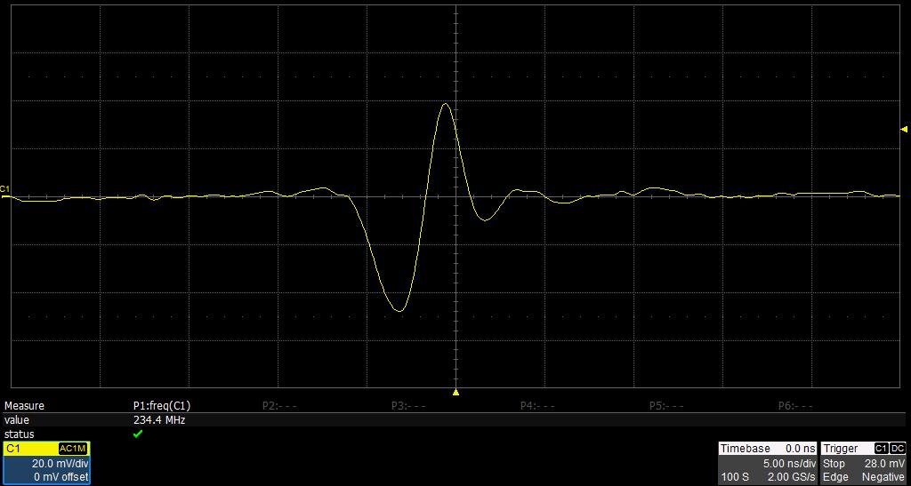

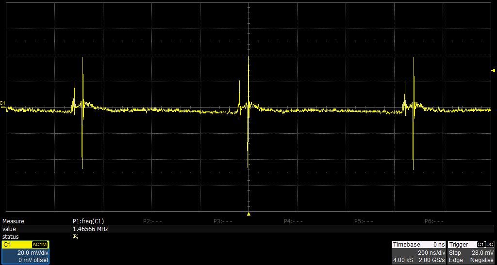

  • Hi John,
    VBUS can come from any USB port. and is directly connected via a 1uF capacitor. I have also tried putting ferrite beads in this line along with lower and higher value capacitors.
    The SYS output goes via an on/off button controller (LTC2950-2), controlling a MOSFET. The SYS output can supply the main product (if turned on) and would draw a maximum of 700mA when powered up. NOTE: I am doing must of the testing at the moment with the device powered off so only current is drawn to charge the battery.

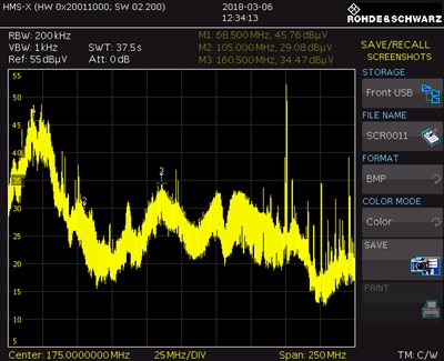

    This is a reference  sweep with the device powered off and not charging.

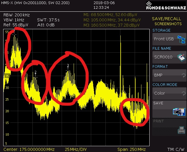

    This is when charging from a laptop USB port and device powered off.
    BAT is connected to a 6.8Ah Li-Ion battery pack.
    I am measuring VBUS directly at the decoupling 1uF capacitor at the VBUS pin on the PCB.
    I am calculating input current by measuring VILIM and using the formula (Vilim/Rilim)*530
    Further testing info:
    Last night I fully charged a device, this morning when I plug it into the main power source (5V, 2.2A USB mains adaptor) I see no spurs on the spectrum analyser. When I plug it into the PC USB port, I can see them but they are very small. Indicating this worse when heavily current limiting on the front end.
    Mark.

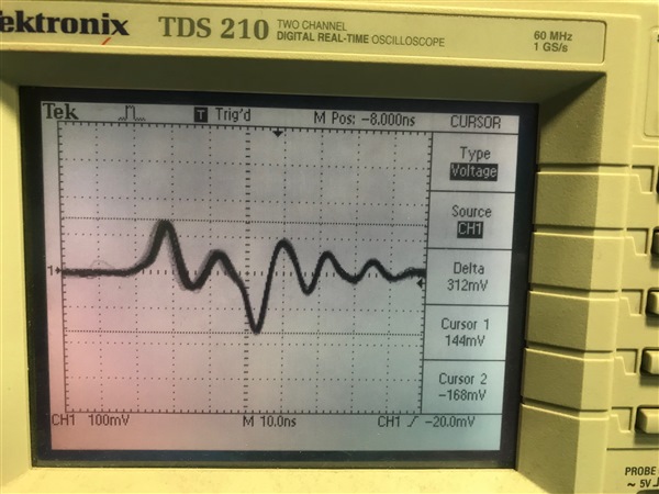

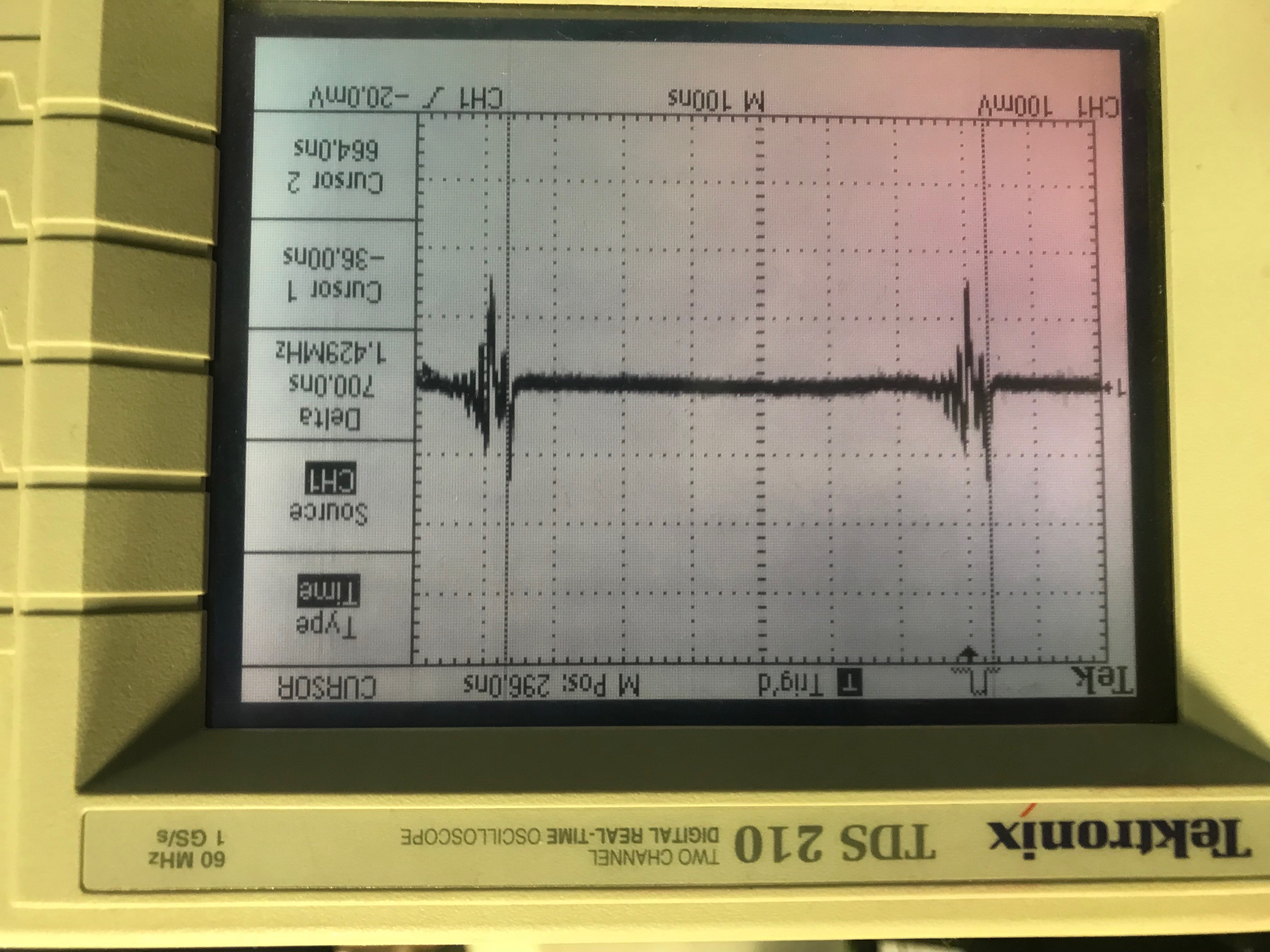

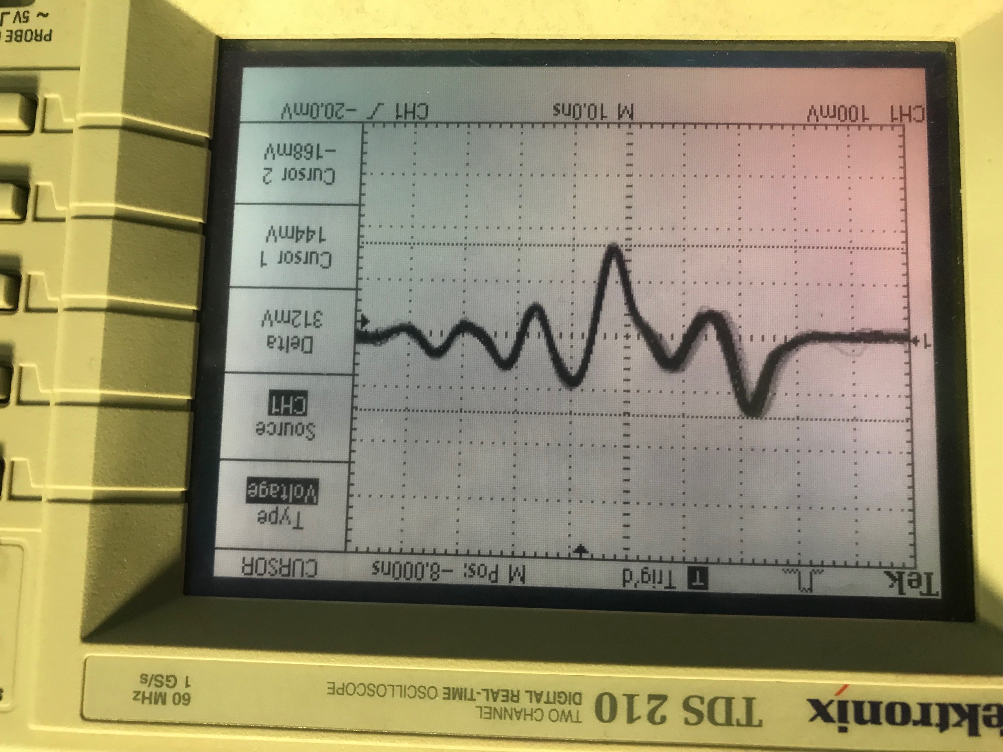

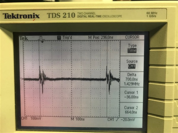

  • Hi John,
    Yes I have a 6.8uF only on PMID
    Below is VBUS with an oscilloscope. showing the 1.5MHz switching, I have then adjusted the time base to show the ringing. My oscilloscope is only 60MHz so not showing the higher order frequencies.
    Mark.
  • Hi Mark,
    Below is VBUS on the BQ24190EVM. This is with VBUS = 5V, VBAT = 3.9V, ICHG = 0.5A, no system load
    The frequency of this noise is expected, but it is clearly much larger for your design. Do you have a schematic that you could provide?

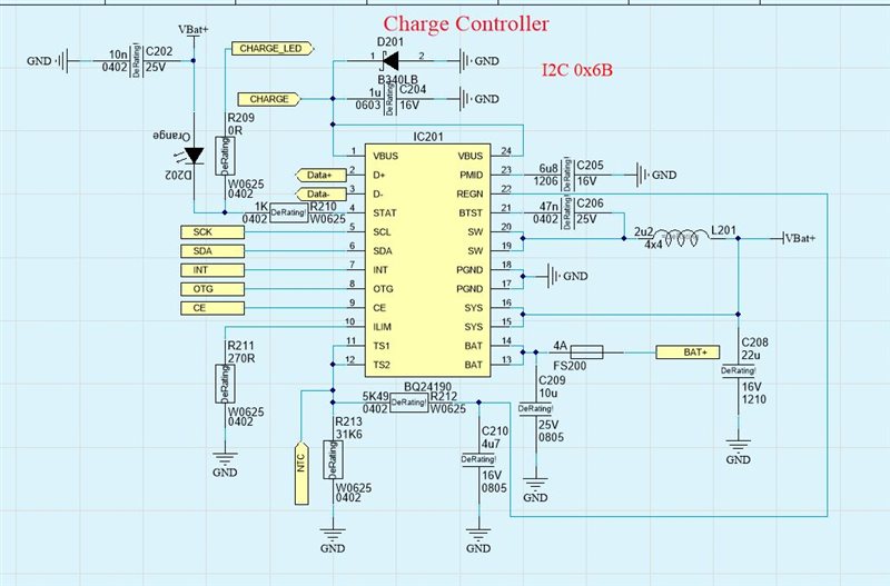

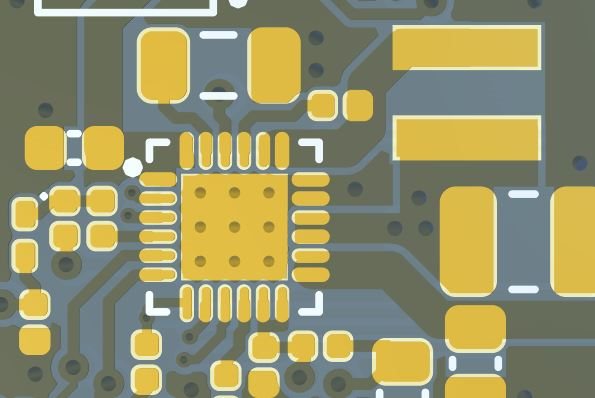

  • Hi John,
    Schematic for charge controller below:

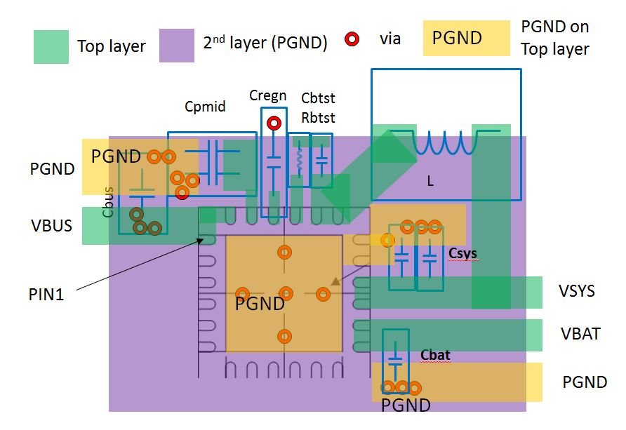

  • Hi Mark,
    There does not seem to be anything in your schematic that would cause this. However, I have noticed that your schematic block does not have a pin 25 for the thermal pad. It is required for the thermal pad to be connected to ground for good performance. Below is the recommended layout for the BQ24190.
    It is very important to have the PMID capacitor close to the IC in the layout. Also, note the thermal pad connected to the ground plane and use of vias. How does this compare with your design?
    John
  • Hi John,
    Do you have access to a spectrum analyser to check out the higher frequencies? I am not convinced the differences we see on the oscilloscope are the cause.
    yes, I followed the recommended layout as a guide for my layout. See Below:
    one thing I have noticed on the recommended layout and the eval board datasheet is the provision for a resistor in the boost strap line. I wonder if adding some resistance would dampen it a little? what are your thoughts?

  • Hi Mark,
    You can order a BQ24190 Evaluation Module from: www.ti.com/.../BQ2419XEVM
    I have two recommendations for ways to mitigate the high frequency noise that you are seeing:
    1. Add a 1nF Cap at PMID to GND. Use a X7R, 0402 and place it as close as possible to the PMID pin.
    2. Add a resistor in series with the boot strap capacitor. Adding this resistor will reduce the slew rate of your high side FET, which will mitigate higher frequencies that may be reflected back to VBUS. This resistor can range from 0 Ohm to 10 Ohm, but the exact performance is something that needs to be tested.
    John
