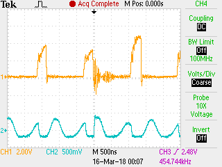

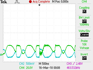

    b. check the HIFET; LOFET gate drive waveform and switching node waveform to make sure:
    Here are settings used w/ BQ Bench Test Software:
    - Option register set to 0x9832 (IFAULT_HI is disabled, LO is 135mV
    - Charge Current = 4096mA
    - Input Current = 8064mA
    - Charge Voltage = 16800mV
    **NO battery actually installed so no charge current is flowing.
    Colors on all scope shots:
    - Yellow is TOPFET, Vgs
    - Blue is TOPFET, Vds
    - Purple is BOTFET, Vgs
    - Green is BOTFET, Vds
    1. No shoot through between HIFET and LOFET
    Taken at no charge - timing of TOP Vgs vs BOT Vgs
    Taken at no charge - timing of TOP Vds vs BOT Vds (this should show any shoot through

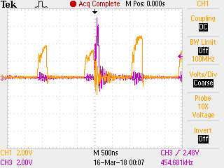

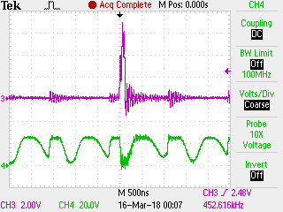

    2.HIFET or LOFET is turned on in 100ns when HIDRV or LODRV signal starts turning on.
    Below are images of Drive (Orange/Purple) vs the FETs ON/OFF (Green/Blue)

  • 1. disable IFAULT_HI and set IFAULT_LOW to "1": which one work? IFAULT_HI appears to be the culprit
    2. From the test waveform, the HIDRV turn-on takes about several hundreds ns. It could be too long. So, the protection circuit measures a high voltage across the HIFET due to the slow turn-on.
    So reduce the BTST and HIDRV series resistor value or select low Qg FET can fix the problem.
  • Thank you. My BTST and HIDRV series resistors are currently 0 ohms so can't do much reduction there. Any recommended Qg values? I'm currently using Infineon BSC0901NSI, Qg is currently 4.1nC which seems very low. Turn on time should be 5nS for this FET.
