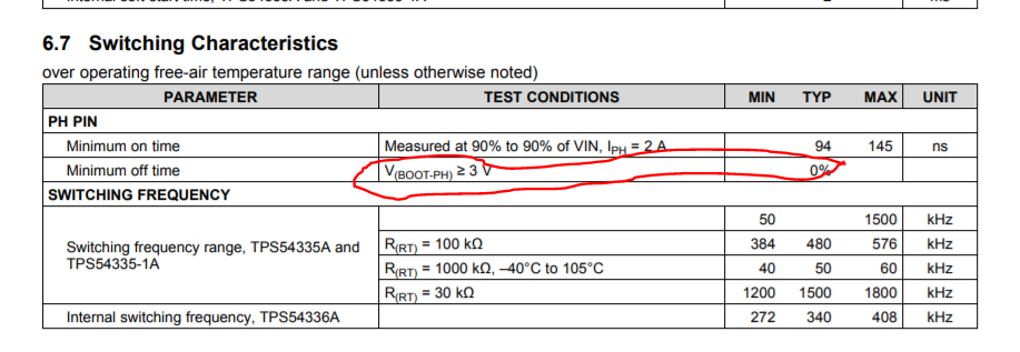

 We are facing an issue on a current design and seek your urgent help using TPS54335ADRCT.
 Details:
The regulator is configured so as to have Vin=5v, Vout =4.5v Iload = 2A.
The switching regulator TPS54335ADRCT is fed by a 5V switching regulator which is sourced by the a power supply (5V @3A)
Due to loading & IR drop the voltage fed to the TPS54335ADRCT  is about 4.8Volts.
The output of the TPS54335ADRCT  fluctuates at around 28Hz with is voltage waveform from 0.8 to 4.5V (a square wave)
 The output tracks the input.
 TI webench calculator won’t provide a solution for a Vin of 5V @ 2A output with Vout=4.5V
 We need some help in reviewing this SW regulator on high loads & temperature stress.
