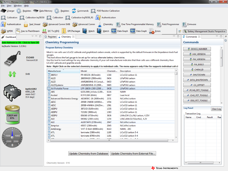

We have a shared PC running BQ Studio with chemistry update 369. I set my battery to use the desired chem ID (0404).
I checked my own copy of BQ studio and it was using chemistry update 576. For some reason, this doesn't have the 0404 chemistry installed. So, I updated it to 616. It's not in that update either.
I downloaded the latest copy of BQ Studio but (not surprisingly) that uses chemistry update 616 too. However the UI of BQ Studio is also now a total mess with shortcuts duplicated and so many more options than normal.

  • Why can I not use chemistry 0404/why is it not available? There doesn't seem to be an alternative chemistry ID that's suitable.

  • Thanks for the reply.
    If I choose gauge 4500_1_06-bq40z50R1 I can see chemistry 0404 in the BQStudio chemistry list
    If I choose gauge 4500_2_08-bq40z50R2 or 4500_2_11-bq40z50R2, I cannot see 0404 in BQStudio chemistry list
    Does this mean that chemistry definition is only suitable for the R1 version or it it an error in what's being displayed?
    FYI, my chemistry file is currently issue 472 and this problem isn't resolved by using the latest 616
  • Hi David,
    Currently when using bq40z50-R2, bqStudio will only display chemIDs which can be used with the TurboMode2 feature and 404 is not one of them.
    We plan to release an updated version bqStudio which will give you the option to display non-TM2 chemIDs for bq40z50-R2, but I can't say when it will be available. Until then, we will program the chemID into a default bq40z50-R2 srec for you and get it to you.
