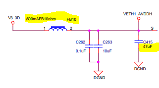

    The total load capacitance of V3_3D : 47uF+10uFx19+4.7uFx1+3.3uFx3+0.1uFx13+0.01uFx78=260uF

  • Shinichi,
    If customer refer to C415 as 47uF capacitor, then it should be noted that there is a Ferrite Bead (FB10) in front of this capacitor. A ferrite bead is a high frequency current "choke" with some resistance resistance, essentially a low pass filter that is slowing down the current into 10+47uF of current.
    If customer have a 10+47uF cap that does not have a FB choke in front, this is a non-negligible difference.
    The same is true for C273 (after FB11), and C383, C391, C388 (after FB20 as V3_3AUD).
    The result would be 47uF+5*10uF = 97uF less capacitance this is instantaneously drawing current from VDCDC4.
    Has the customer considered the effect of the Ferrite Beads already?

    I understand when the ferrite beads are connected, the inrush current of the output capacitor can be mitigated.
    I checked the customer's connection, there are ferrite beads the same as EVM.
    So I ask him to change the same capacitance(10uF) and check.
