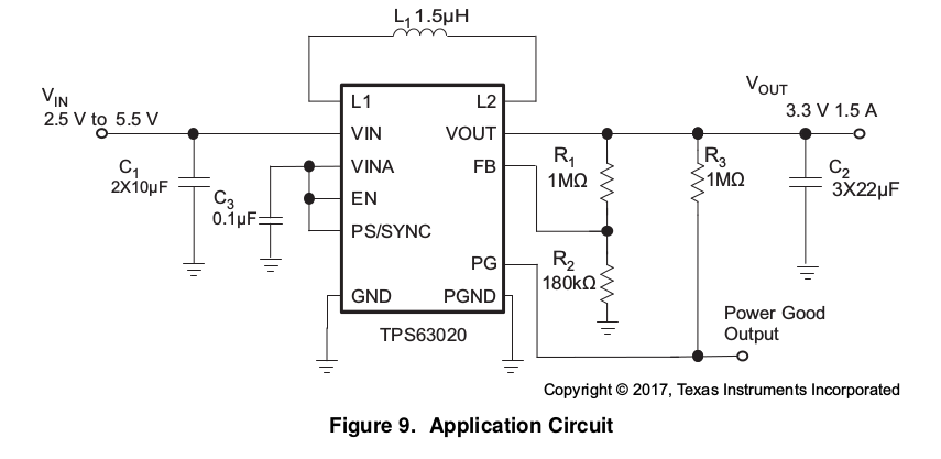

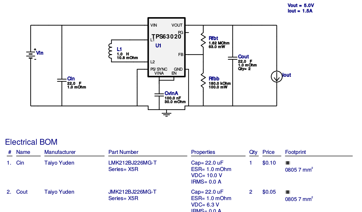

I have a query regarding application circuit of TPS63020. I have found different application circuit in datasheet and the design generated by TI web-bench designer.
Please find the below images for reference
          ( Typical application circuit from datasheet)
Design generated form TI web-bench designer
Input parameters given for TI web-bench designer: V in= 3.6 V to 5.5 V, Output: 5 V, 1.5 A
In both the circuits, different number of input and output capacitors and different value of inductor are suggested.
Please help me in which application circuit has to implemented
Also please tell me know what difference will I get in performance w.r.t two designs

  • Hi Sai,
    The input capacitor seems to fine in both the cases. Regarding the output capacitor the webench recommendation is sufficient, but using higher capacitance helps to reduce output ripple, and less voltage drops during load transients.
    For the upper resistor of the feedback divider (Rfbt) I would recommend not to use a higher value than 1Mohm.
    The inductor is fine in both cases.
    What is the end application?
  • Can you tell me how to simulate load transients in TI web bench designer ?
    Please suggest me a value for feedback divider (Rfbt)
  • It can easily be done by going to the "Sim" tab at choosing load transient on webench.
    Please take a look at section 8.2.2.5 of the datasheet to calculate the feedback divider.
