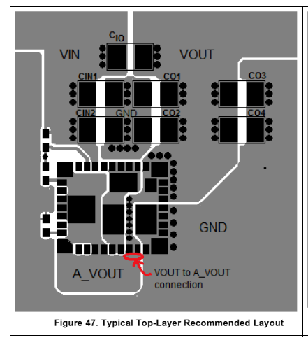

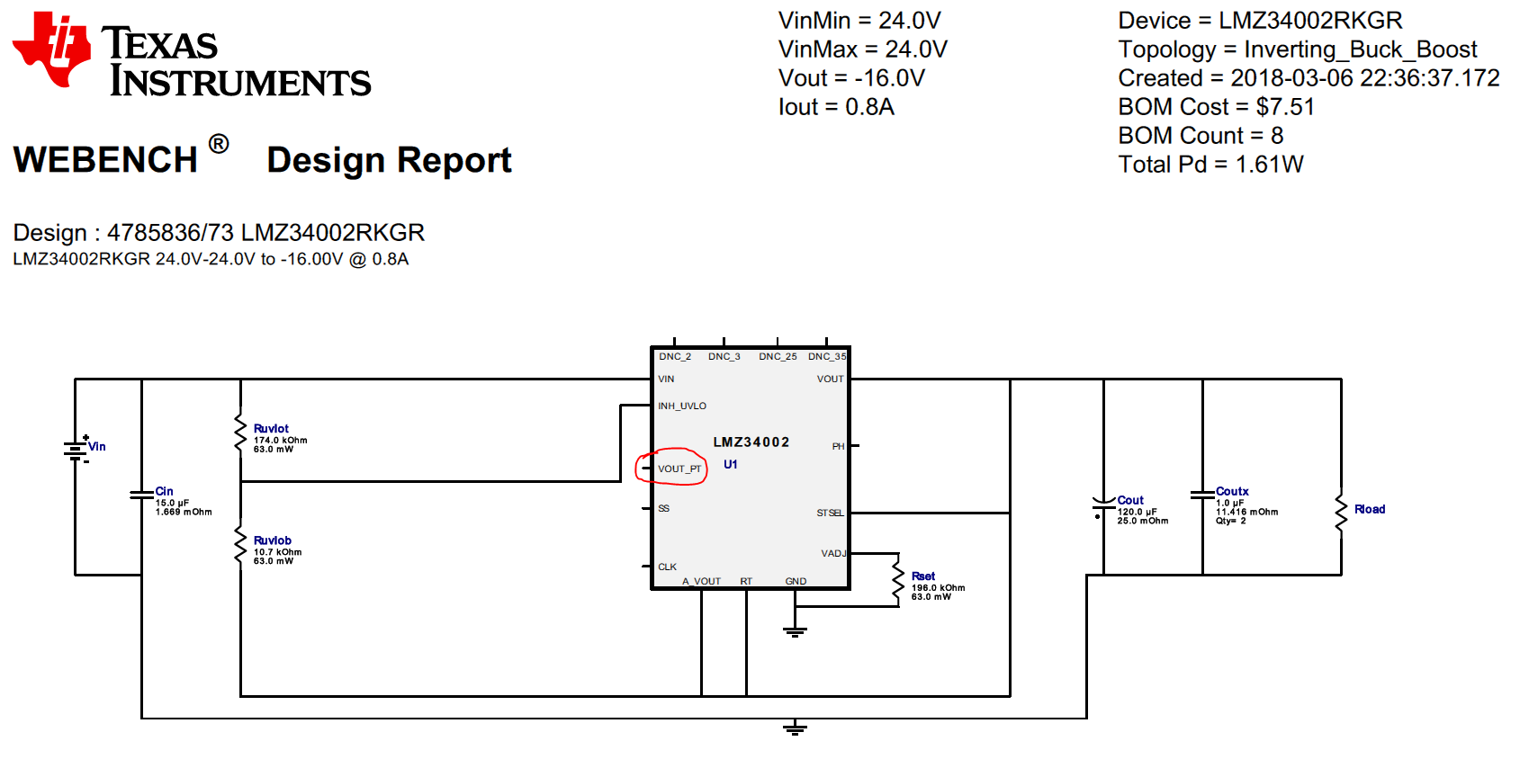

I am designing a -16V circuit using a webench.
On Datasheet layout, VOUT_PT is connected to VOUT and A_VOUT.
But on webench design, VOUT_PT is not connected to VOUT nor A_VOUT.
I will refer to layout of webench, but I'm not sure if i need to connect VOUT_PT to VOUT or A_VOUT.
