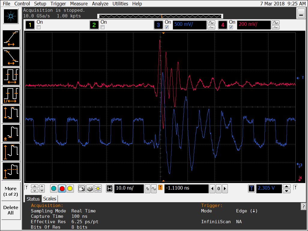

My system is actually characterized by an high HF noise due to ringing oscillations.
I had measured these HF spikes on both input and output nodes.
This noise actually afflicted some LVDS signals and makes my system fail.
Here you can see that this noise afflicted the clock node.
This spike played as common mode noise but its amplitude bring each single ended signal out of their 1.8V rail.
Is there any way to reduce this spikes?

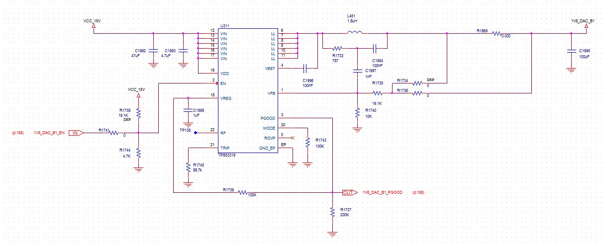

    What are the waveforms you are showing?  Can you share your schematic and layout?
  • Hi John,

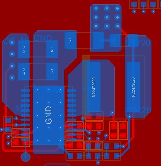

    Sure, I'll posted down here a snapshot of my schematic and Layout.
    What I showed it's just one of the DCDCs output embedded on the board (violet waveform) with its HF spike noise due to the ringing.
    The blue waveform is just  one of the signals corrupted by this coupled noise.
    I can capture same ring noise (higher in amplitude and not showed in scope screenshot) at the input node too (VCC_15V) and in this case this is the net who drives the digital net to move its common mode.
    Consider that I have different DACs with same digital interface on my design and just couple of them fail the interface test.

    Here my schematic on this DCDC
    Down here a snapshot of the Routing
  • I don't see any issue with the layout or schematic.  You will always get some switching noise on both input and output.  Here are some things you can try Two of witch you have already done:

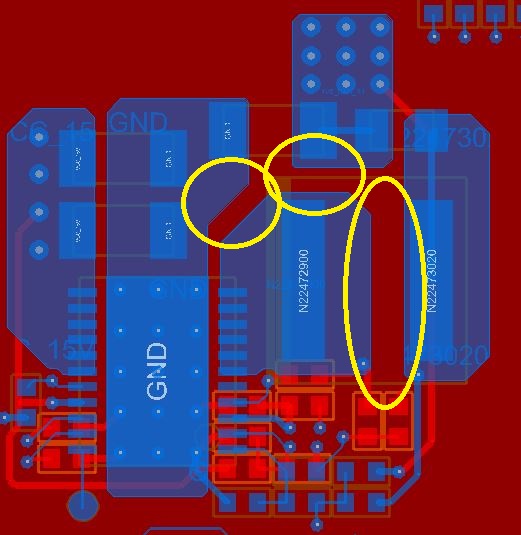

    regarding routing I have couple of doubts:
    I'm comparing tps53319 datasheet layout example with TPS53319EVM-136 evaluation module routing.
    I had noticed that feedback components in datasheet example are placed on TOP layer while in EVM all the path is on BOTTOM side of the board.
    My layout follow datasheet example, does it plays a role on ringing amplitude?
    Improve in air gap between switching node and output node, as well as ground node will introduce some benefits?
    refer to circle:
    Alessandro Ranieri
  • That post is mostly effective for filtering out additional switch frequency ripple. You would want to have that outside the FB loop. You likely cannot compensate for 2 double poles.
    In your case that may or may not be effective anyway as your frequency is of interest is around 250 MHz. At that frequency parasitic effects tend to dominate. Any large value ceramic capacitor will be inductive at those frequencies. That is why I recommended multiple low value incremnts in parallel (0.1uF, 0.01uF, 0.001uF, etc).

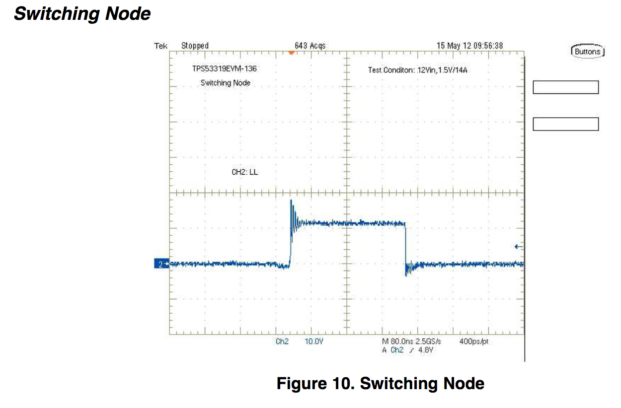

    For a redesign I would like to understand if these approaches can be useful, can you confirm that with the TPS53319 EVM I would be able to generate ringing in order to test couple of these solutions? This will be necessary to be confident that a redesign will be effective.

  •  Enclosed please find a waveform of the SW node with ringing:
