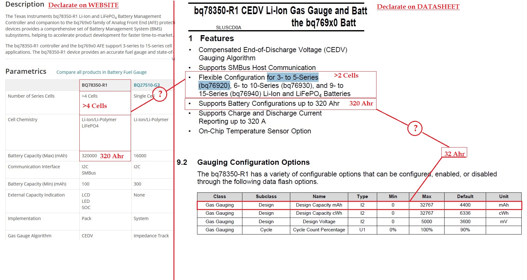

  • Hello Eric, about 2-nd question:
    1) I am intresting BQ78350-R1 with companion of BQ76920.
       Looks like:
       A) BQ76920 has measuring CC with complete BMS on board (includ balancing 3-cells parallel, fet control, protection and etc...).
       B) BQ78350-R1 has gauging alghorithm which use value reading from registers of BQ7692.
    But I see information conflict between datasheet and website.
    Please, tell me -  this supports the configuration up to 320 Ahr for 3-cells parallel?
    My task is to find a replacement for the obsolete BMC microcontroller - 120 Ahr, 3-cells parallell, Li-ion.
    Thank you, Danil
  • Hi Danil,
    I would recommend you create a different post on the bq78350 so you can have your questions addressed by the appropriate team.
    thanks
    Onyx
