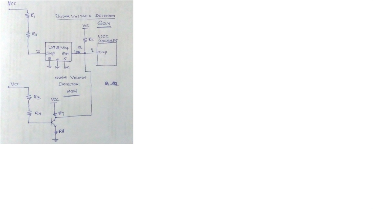

    This system should operate from 62V to  143V AC.
    I have made quick hand sketch schematic for your inputs and advise attached.  I have included a small transistor logic to cut off at 143V AC.
    Kind request you to let me know your views.
    Thanks in advance.
    Rajesh
  • Hi Rajesh,
    You will want a resistor connected from INPUT to ground of LM8364 to form the divider. I would suggest not connecting a resistor from Vin to COMP, you will want the internal error amplifier to drive COMP under normal operation. You can connect a resistor from INPUT to RST to add some hysteresis to the UVLO threshold.
    For the overvoltage circuit, I would suggest adding a 75V zener and 68V zener in series with R3. This will give you a discrete threshold for when the overvoltage circuit engages. You will want a resistor connected from the base of the transistor to ground as well. I would suggest leaving R7 out of your circuit for the same reason as R5.
    Ben Lough
